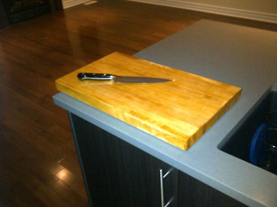

I had been debating purchasing a low angle bench plane for a long time. I decided to go for this one because I was in need for a dedicated smoothing plane. I had been looking to replace my newer production Stanley no.4 which is extreemly low quality and very fussy to use. I am so glad I went for the LV BUS, it really is a dream to use and it takes super thin shavings for fun.
I am in the process of making a custom kitchen cuting block for my wife and I was getting discouraged from trying to surface the end grain rock maple to an acceptable finish. I went and bought the plane, polished the blade up to 8000 on a waterstone within 5 minutes. After a few passes the board had a miror like polish from the planing. I was really blown away by the performance of that plane.

[*] posted on 7-19-2011 at 06:10 AM
just a quick pic,
sorry for the camera phone quality.
Ottawa-20110717-00111.JPG - 25kB
