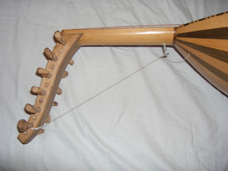

Well then, here's a field repair with metal screw and broken neck as well.
I bought a very cheap oud on an ebay auction to take with me on my last trip to Europe, since I was planning to camp, and didn't want to leave a nice
oud in the campground while I was out and about for fear of theft. At the end of the 2nd week of the trip I noticed that the action on the oud was
getting very high, and I thought maybe it was the humidity and heat causing this, but, no, the neck was cracking on both sides, and the head was
lifting up due to the tension of the strings. The cracks were growing quickly, and I had to find a way to fix the oud without delay, or I'd be without
it for the last week of my trip. I was in a cheap hotel room at the time, so I extracted a screw from the wall, and screwed it into the base of the
neck, near the body. Then I took the lightest wound string from my spare set of strings that I always carry, and tied one end of it to the screw, and
the other to the head of the oud, and, using some leverage techniques, torqued the head back down, and the crack disappeared, and the whole thing
stabilized. I was able to play the oud without any further problems for the remainder of my trip (see the image). I returned the screw to the hotel
wall before leaving, and flew back to Canada, where I did a quick repair on the oud using another metal screw, driving it into the top of the neck,
through the lower part of the head, and briefly into the neck that lies just beneath the fingerboard. Not something that anyone would want to do with
a decent oud, but for one that cost me $70, it's fine again and ready for another adventure.

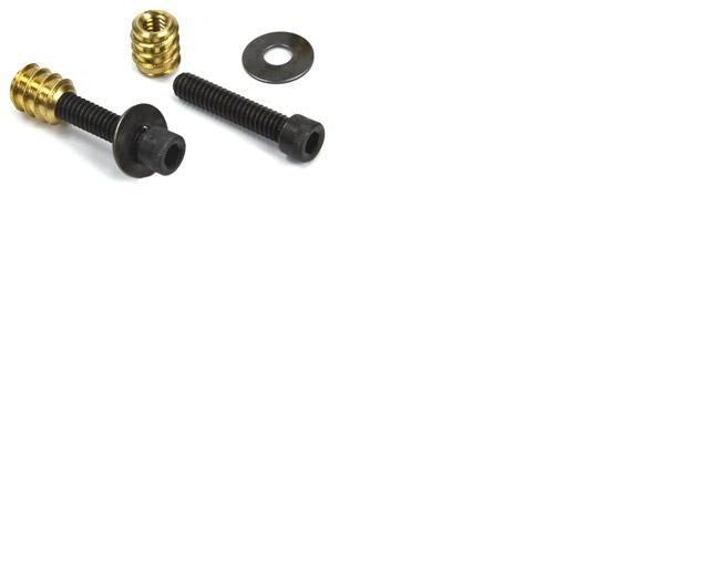

The best method is to use a threaded insert. These use a much larger wood thread on the outside, and a machine screw thread for the attachment screw
or bolt, with a flat washer.

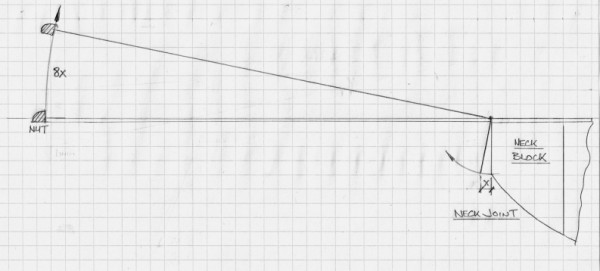

Isn't a truss rod strictly to compensate for bowing in a mandolin neck? The short oud neck doesn't tend to bow. Is the concept to use a truss rod the
somehow adjust the joint angle?

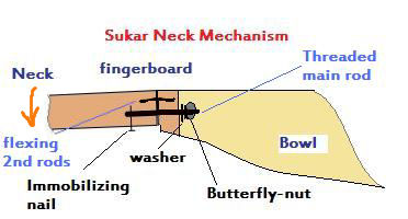

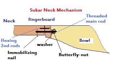

For those of us who like an adjustable neck-body joint, the Sukar design is minimal. It lacks the necessary range to cover all cases of settling over
the years. To extend the adjustment range requires taking it apart to sand/file the mating surfaces.
Although many people can do it without having extensive skills or tools, this is a nuisance. I suppose if it left the bench capable of a wider
adjustment range, the design could be considered adequate, but can anyone accurately diagram the Fadi Matta design so we can draw inspiration from it
as well?

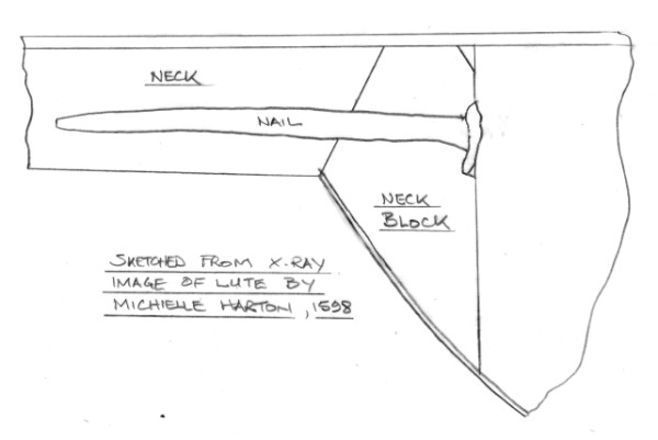

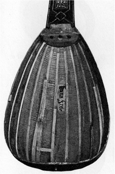

butt joint alone will not serve without some form of additional reinforcement. Lutes of the 16th and 17th C (and violins up to the 19th C) had the

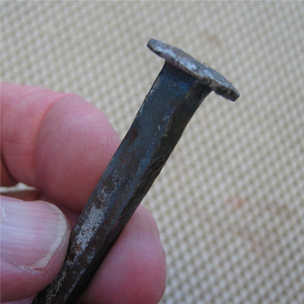

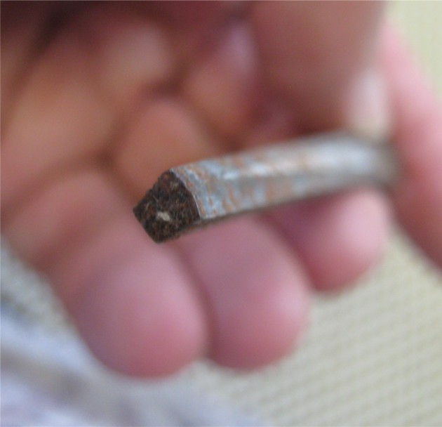

necks glued and nailed to the neck block. The attached images show the type of the single hand forged, square cut, nail that was used on lutes (the
images are ones that I made to demonstrate how it was done). The nail aligns the neck to the neck block and allows a clamping force to be immediately
applied - necessary when working with fast setting hide glue. The nail then provides the necessary additional reinforcement to the joint. Clearly a
joint made this way is not intended to be taken apart so sufficient material is provided in the neck/fingerboard to allow any adjustment to string
action - if required - to be achieved by planing the neck with the neck still in place.

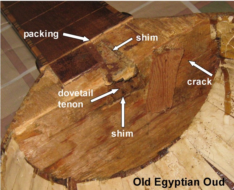

An old method used on some ouds was to use a dovetail mortice and tenon joint. The attached image shows the arrangement on an old oud that I purchased
in Cairo in 1963 - no date on the label but probably made in the late 19th/ early 20th C. It can be seen that adjustments have been made to the
dovetail to reset the neck alignment (by adding thin wooden shims) and also demonstrates a potential weakness with this type of joint - the wedging
action of the dovetail has caused the neck block to split.
This type of joint is difficult and time consuming to make by hand with precision so some modern makers prefer to use a simpler (but effective) spline
joint or a dowel.
Is there any evidence in the surviving old ouds to confirm that nails were used to fix the necks as they were on lutes? After all it is the simplest
and most straightforward solution and - as lutes were supposed to have been developed from the oud - one might expect that nails were used on ouds at
one time as well?
I am currently preparing an article (for the lute making fraternity) on the use of nailed joints and how to make the nails - for the benefit of anyone
that would like to try the technique. I shall post details later on this forum - as a separate topic - for information.

I fail to understand the reinforcement characteristic of the nail. It is small in diameter, and very different material. This difference affects it's
expansion/contraction as well as it's adhesion characteristics, so how can it reinforce the joint? I think it was just used to align the neck while
the glue cured. The nail can't make the joint permanent, just not possible to repair with another nail.

Furthermore, if a neck joint is not also reinforced, after time and humidity cycling, the glue will weaken and the joint start to 'yawn' (under the
bending moment due to string tension) starting at the bottom of the joint which is the highest stress point. Hide glue significantly weakens at
Relative Humidity values over 80% and expands. It will reharden again when the RH drops to lower values but the glue will not shrink back to its
original dimension It only takes a small separation of the joint to produce a magnified larger movement of the nut as demonstrated in the attached
diagram.
The European luthiers of the 16th to 18th C solved this problem by using a nail or nails driven through the neck block into the neck. The nails used
by the lute makers were forged square in section with large diameter heads and were about three times the thickness of the neck block in length. This
type of nail - or more properly 'spike' - unlike the thin wire nails generally available these days can be driven into wood without splitting it and
grip so firmly once driven into place that they are very difficult to remove - especially when surface corrosion sets in.
The purpose of the nail is to hold the neck in proper alignment and provide sufficient clamping force on the joint before the glue starts to gel -
speed is of the essence here. The nail then securely holds the joint together and so reinforces the joint against separation should the glue become
temporarily weakened in humid conditions.
As an example, the attached sketch is drawn full size from an X-ray image of a late 16th C lute by renowned lute maker Michielle Harton made in 1598.
So over 400 years later the lute with its neck joint and reinforcing nail survive intact. The dimension of the nail scaled from the x-ray image is
about 6 mm square by 90 mm long with a head 15 mm diameter. The additional joint strength provided by the nail seems obvious.
Another example (but there are many more) shows a lute by 16th German maker Hans Frei - that was fitted with a wider neck during the 17th C - with
three nails driven into the neck.

I suspect that in spite of a more sophisticated appearance, the Fadi Matta design is not all that different:
http://www.youtube.com/watch?v=s09aZgHejE8
Fadi Matta covers the gap area with an elegant brass piece, while Sukar uses a wooden strip. The position of Matta's two adjustment wheels suggests
that the "lock" nut and the "adjust" nut are on one threaded rod in much the same position as Sukar's. Is there a threaded insert in the neck block,
or just an immobile nut? Are steel rods used to allow flexing, or is another mechanism used? Does anyone know?

Just to provide a reference for those not familiar, LMII has these:
http://www.lmii.com/CartTwo/thirdproducts.asp?CategoryName=Truss+Ro...
Separately, the Belleville conical washers are a nice replacement for the flat washers that Sukar uses.
