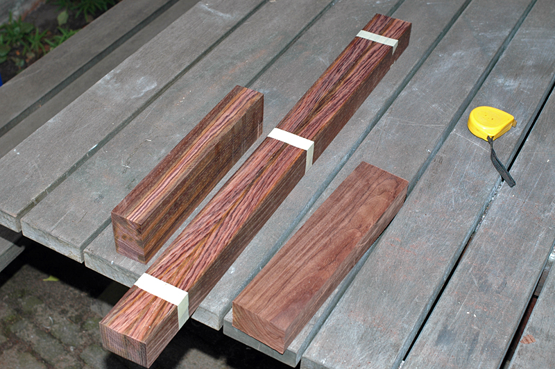

Today I have come across a very old and beautiful piece of wood.: Cocobolo. I couldn't resist it and although it is an expensive wood. so I took it home and had very good look at it before i started cutting.
it is 115cm cm long 4,5 thick, and 34 cm wide.
Luckily the crack (see picture) stops far away form the safe 70cm needed for the ribs.
for now I have cut only 19 ribs needed of one oud,
The wood is so nice inside with some figures.
Does any one have a picture of a cocobolo oud? or any experience. it would be nice to share.
It is a true rosewood and seems to have very good tonal qualities
DSC_9631.JPG - 627kB DSC_9646.jpg - 491kB

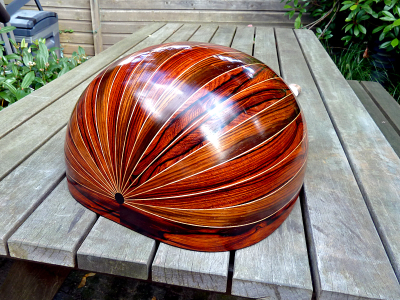

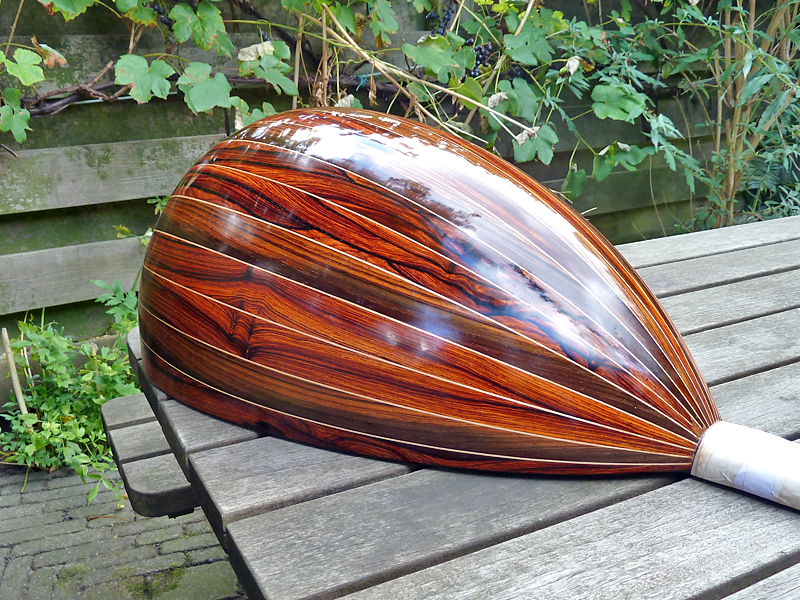

Hi Chris, Samir
I guess the only way to find out is to make a Cocobolo oud :)
this piece or cocobolo was found by chance in a big log.
Difficult to work with the swirls though, a rasor sharp planner did the job. because the cocobolo is a bit oily itself, is is a pleasure to work with. cleaning the joints with naphtha before using the glue is a must.
The left side of the bowl has also some boomatching.

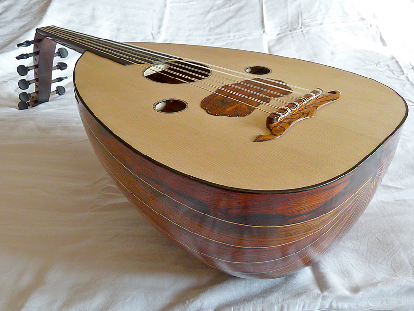

[*] posted on 9-24-2011 at 06:51 AM

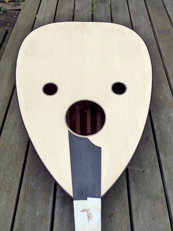

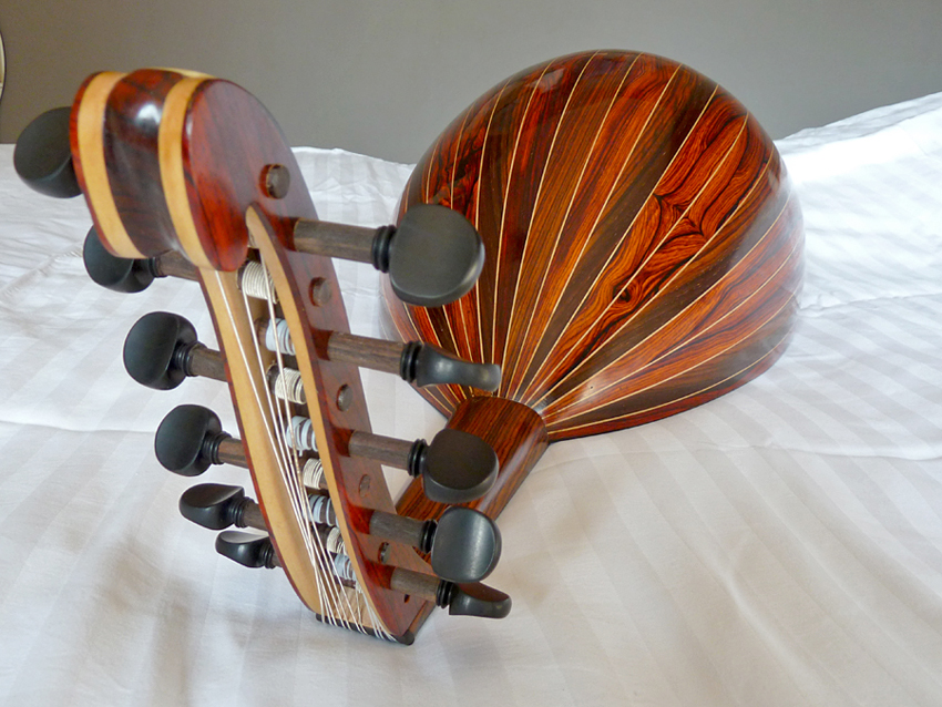

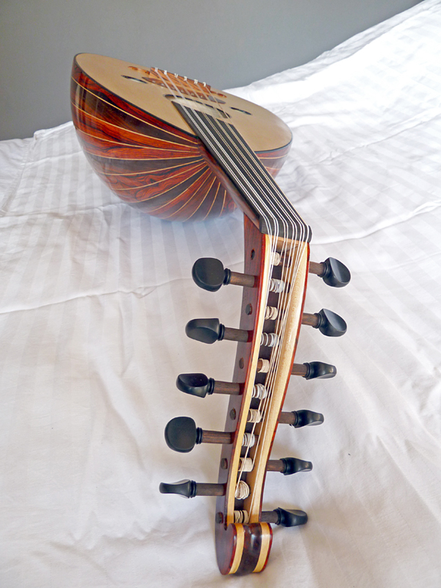

Finished
Strings are up, just finished today
bowl 49,5 X 35,5
European spruce top
Ebony fingerboard
Brasilian rosewood bridge and pickguard (pickguard is rounded by 3 different wood colors )
cocobolo neck
cocoblo\maple pegbox
ebony purflings
soundboard and oud are french polished.
the oud sound very nice, and as always will need some time to grow up.
cocobolo 1.jpg - 404kB
cocobolo 3.jpg - 600kB cocobolo 2.jpg - 462kB
Best regards, Samir
