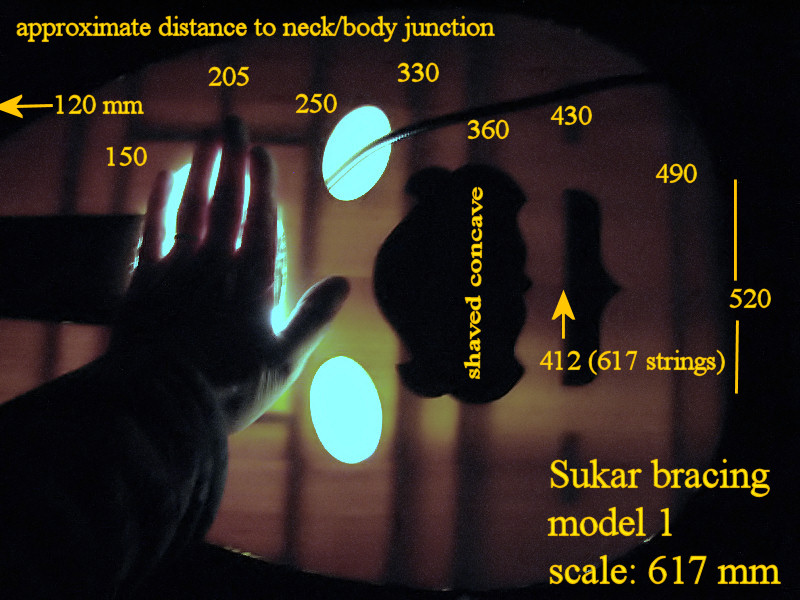

For what it's worth, here is the bracing on a 617 mm scale fixed bridge Model 1 Sukar. Measurements are approximate to middle of brace, from the
neck/body junction. The bridge is 412 mm from neck-body junction, and 617 mm from the nut. One brace, the one marked "shaved concave" is in fact
carved out so that at the center of the pick-guard it's barely 1 mm high. Elsewhere, the bracing is about 17mm high. The soundboard itself seems most
thinned out under the pick-guard.

Thanks Fernand raynaud for thos informations.
