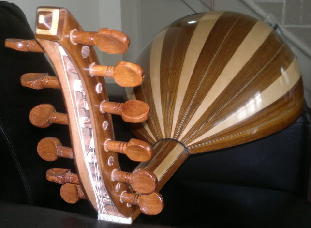

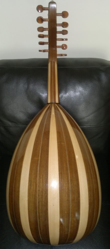

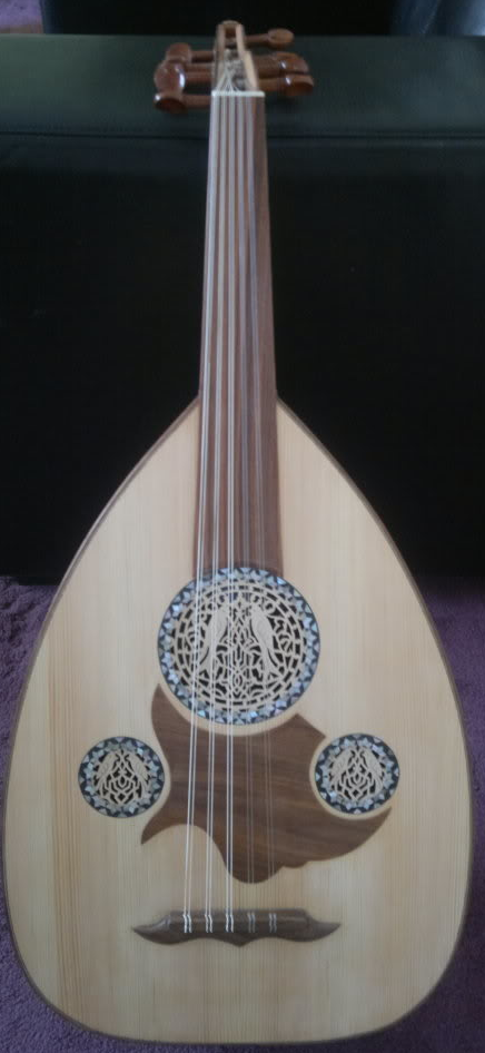

I posted a few months back about tuning issues on a Moroccan oud and got a huge amount of help from people so thanks again! I got myself an Egyptian oud (I'm pretty sure it's made by Sayed Fathy Amin, pictures posted), which is far easier to keep in tune and I have also managed to use it for performance, though changes in humidity and temperature do affect it a lot (as you would expect). Yesterday, my rehearsal room went up to 77% humidity at about 25c and it was very difficult to keep it in tune.
I'm pretty sure the pegs are not rosewood or ebony and I recently made enquiries about the cost of replacing them (I'm not that experienced in instrument maintenance myself), for which I was quoted £100 ($160), plus pegs. It was from a very good luthier in London. I know I could get hold of some viola pegs pretty cheaply.
Staying in tune live does concern me, as I play with a guitarist so being in tune with myself is not the only concern. So far I've had no big issues but you never know what the conditions are going to be like in a venue.
I'd be very interested and grateful to hear people's opinions - should I:
1) Do nothing and get over it!?
2) Have the pegs replaced with ebony/rosewood?
3) By an electric oud with machine heads? I like the look and feel of a real oud but if my only option is to go electric, I'll have to go ahead and do it. I'm using a k and k dual spot with a DI box, with good results at the moment.
Thanks!
Front.png - 332kB Head.png - 418kB Back.png - 437kB

[*] posted on 8-22-2011 at 02:31 AM
Hi smast,
For sure it is not ebony or rosewood. I'm not a specialist but if I remember well I read somewhere on this forum that ebony "sands" the hole which is softer... But more important : is it me or pegs are not straight (first photo) ?

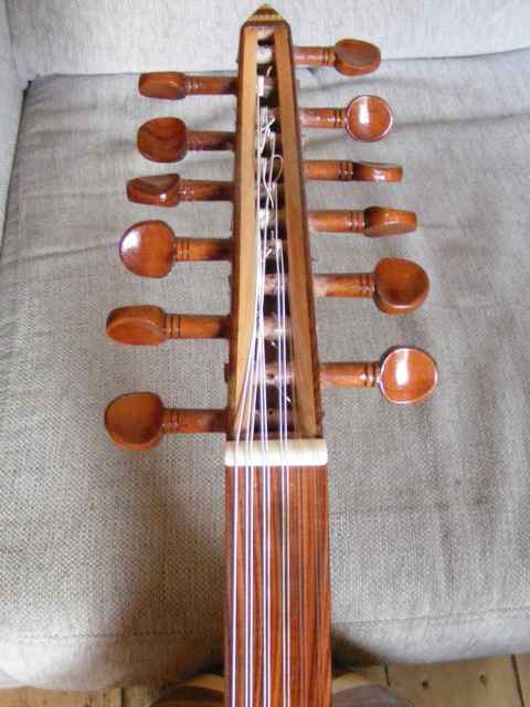

[*] posted on 8-22-2011 at 02:54 AM
Hi David,
Thanks for your reply. Yes - I was pretty sure they are a softer wood. My fault - I posted a photo of the same model but I don't think it's my actual oud. The photos posted were by the seller and I think it may be a different instrument. Here is the head of mine - I can see what you mean about the previous photo - it doesn't look quite straight.

[*] posted on 8-22-2011 at 04:32 AM
Yes, this pegbox looks fine. Ebony or rosewood would help the oud to keep in tune, but of course, you've got to make the holes perfectly fit to the pegs. Also, strings are an important factor. Personally, I use Daniel Mari and the G strings are systematically out of tune, temperature, humidity... Question of matter I guess, because all the others keep in tune much longer.
