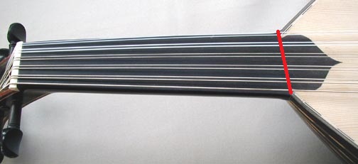

Pundit is right. Looks and sounds good. Good deal. The little separation on the back doesn't matter unless it rattles. You can fill it, e.g. with a
little liquid hide glue with a bit of sawdust if you want. Check the height of the strings at the neck-body junction. For a zingy sound you want
about 2-2.5 mm. For a more percussive sound 3-3.5mm. You can adjust the height a little by how you position the string loops at the bridge (loosen the
strings one at a time to rotate the loops up or down). If you find the strings are showing sign of wearing grooves in the fingerboard, i.e. if the
wood is soft, you can coat it with a hard wipe-on varnish (see the many discussions on the forum). That will also brighten the sound, with longer
sustain. You might want to buy some new strings, they never come with good strings. There are different materials, like PVF instead of nylon for the
plain strings, a bit more metallic sounding, so there's no discontinuity in timbre with the wound strings. You've got a lot of discovery in store.
Play it a lot. The more you play it, the better it will sound, the vibration causes it to "open up". It looks like a great buy. Welcome to the oud
community!

Thank you very much! I'm a lot happier now.
The Oud truly seems to get a better sound since I've bought it.
There is a little rattling when I'm playing a bit louder and close to the saddle. Especially the third string. I think the fingerboard isn't
completely even.
I will try to height the strings a little like you explained. I hope that will fix the problem.
You mean the height at the marking on the picture?
Yes, exactly. Most of us here like the Egyptian timbre, more snap and less buzz, but a little zzzzing is lovely too. Of course the fingerboard should
be even. If you find little problem areas, you can wrap sandpaper on a long-enough wooden block and level the fingerboard if/when you get around to
coating it.
