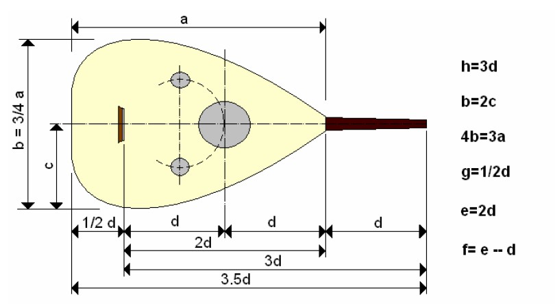

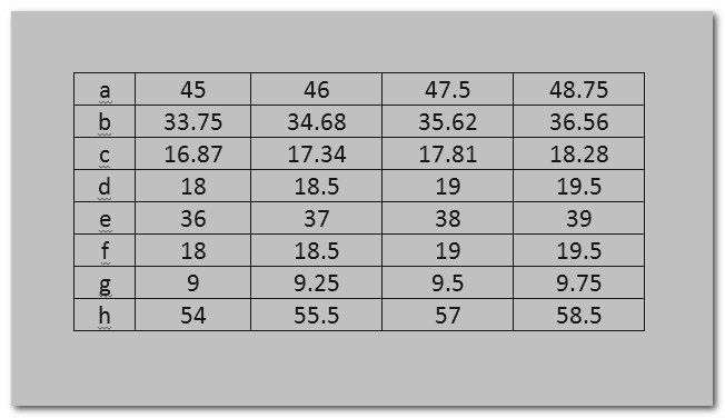

i draw a shape 47.5 cm scale. it can help to beginners.
Attachment: qq.tif (364kB)
This file has been downloaded 996 times
Attachment: 3.tif (328kB)
This file has been downloaded 830 times

İ decided to draw templates for beginners like me :)
i need help and every documents are important for me..
Edit: i add 2 photo about scale
oud 1.jpg - 43kB oud 2.jpg - 41kB

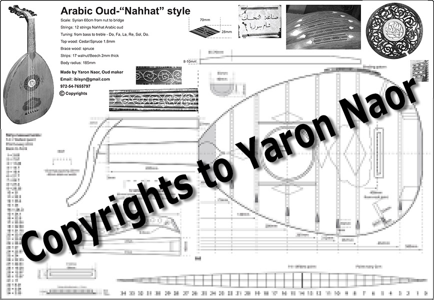

I have one
Contact me if you would like one
Yaron Naor
Arabic Oud Plan yaron naor.jpg - 172kB

Yaron, which member of Nahat do you think this oud was ? It is a very interesting piece you propose, as your book Richard. Great for new makers to get references
If i'm correct, this one is, from the bridge toward the neck body joint:
Major 7th - major 7th - major 2nd - perfect 5th (middle of sound hole) - major 2nd - major 7th
So different from the Abdo, which has octave braces, as I oftenly noticed in many ouds. But near also in the way of emphasis on major 7th and 2nd.
I know this is very theoretical, but I'm very keen in feedbacks on this subject. What feedback did you get on this antique oud, qualities as criticism ?
