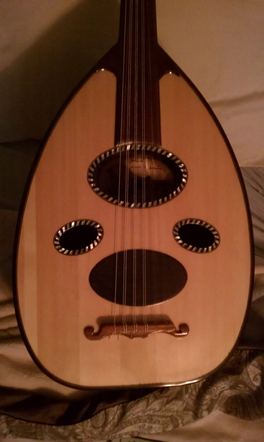

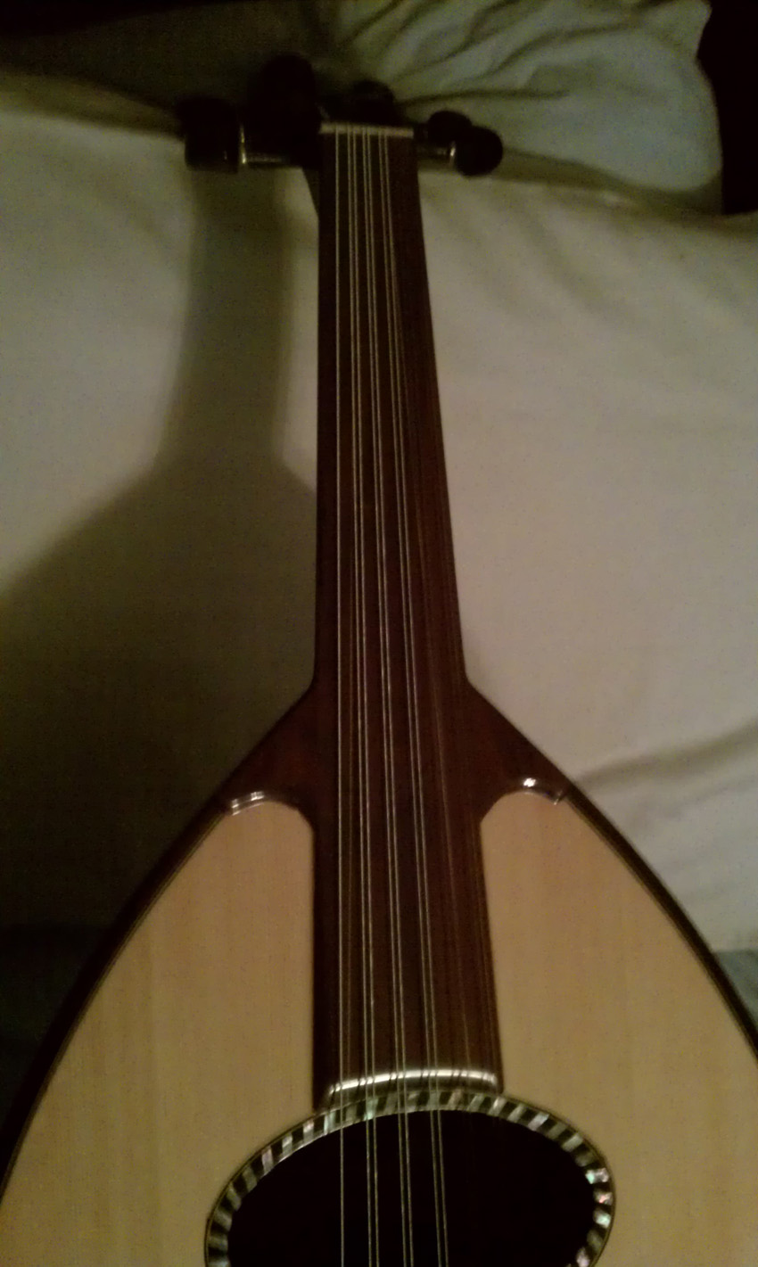

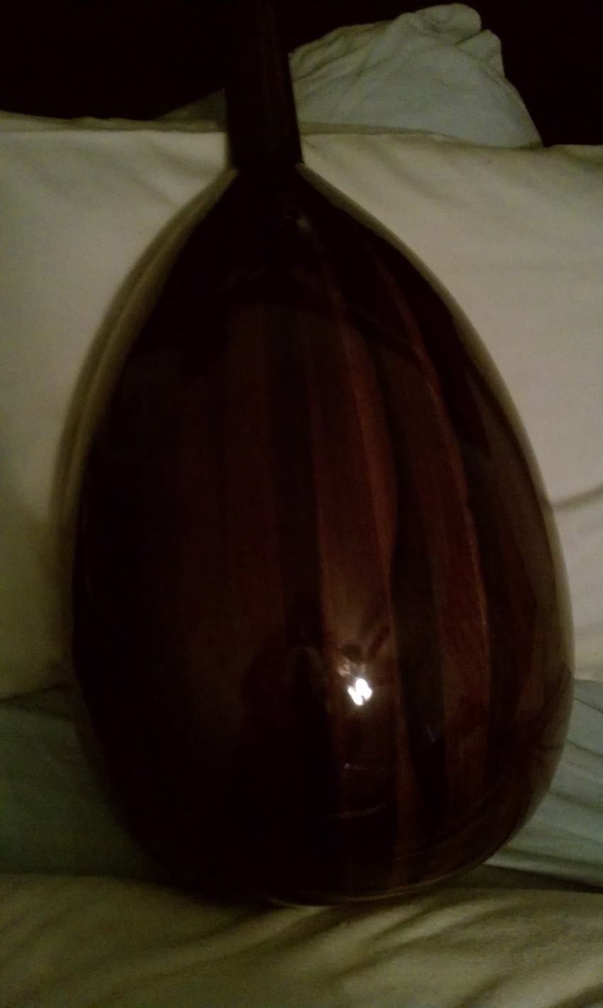

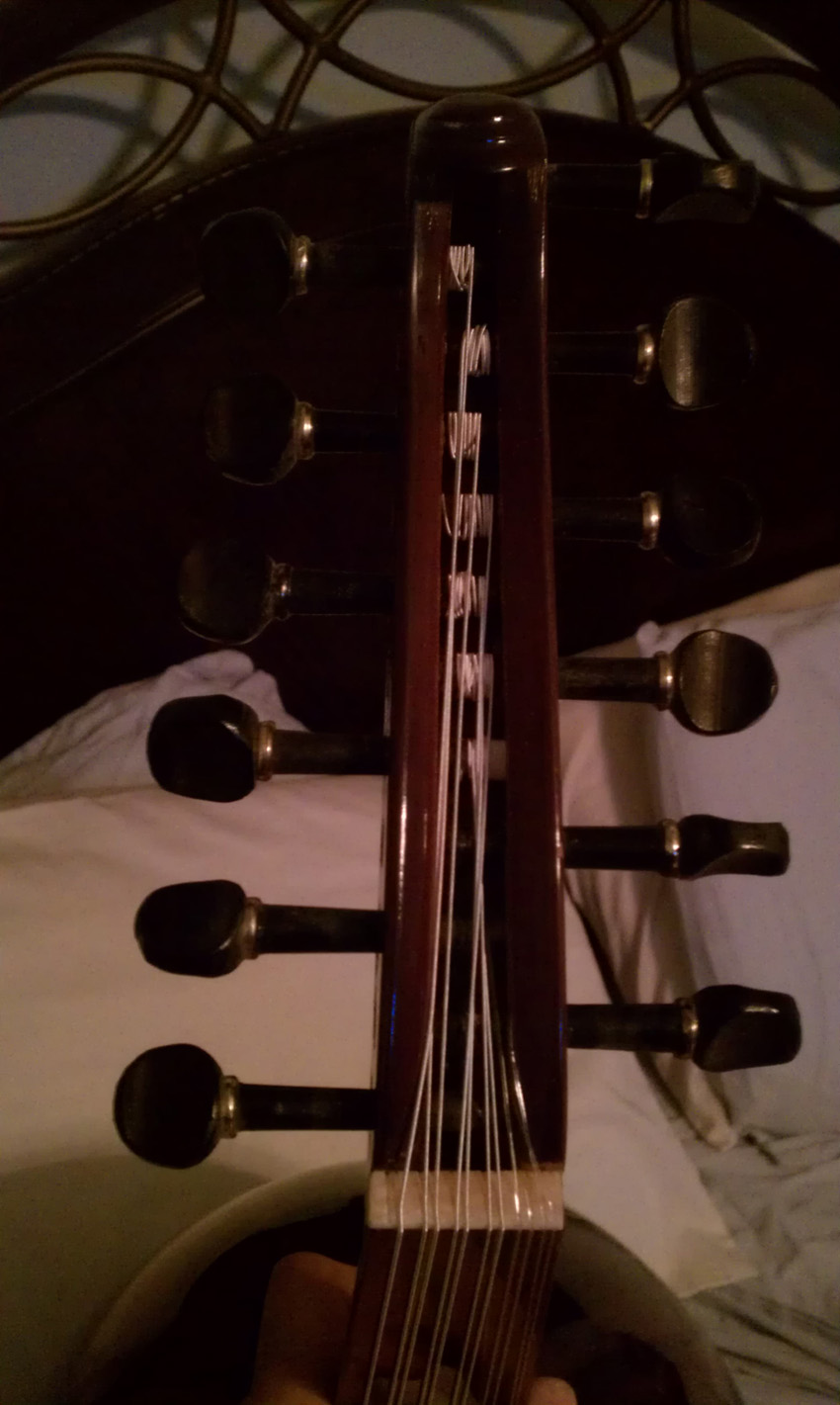

[*] posted on 1-4-2012 at 02:23 PM
Here are some pics of the oud. One of the biggest construction flaws, is in the nut. The g,c courses are practically on top of eachother as the string spacing was not measured properly. Across all 6 courses the string spacings are inconsistent at the nut. Surprisingly they got it right at the bridge end. I put brand new D'Addario strings on it the day I received it. It still does not have the greatest tone and zero sustain.

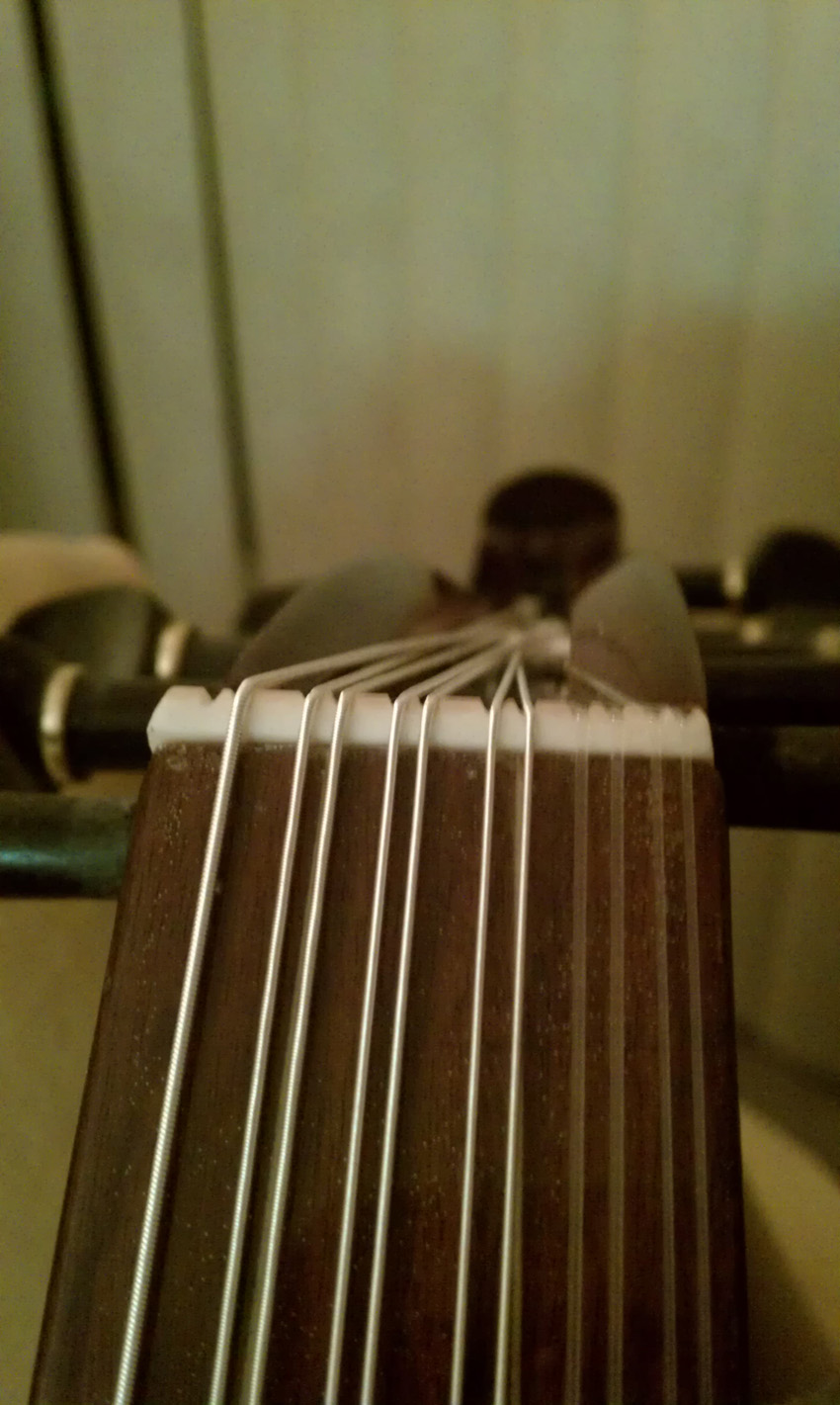

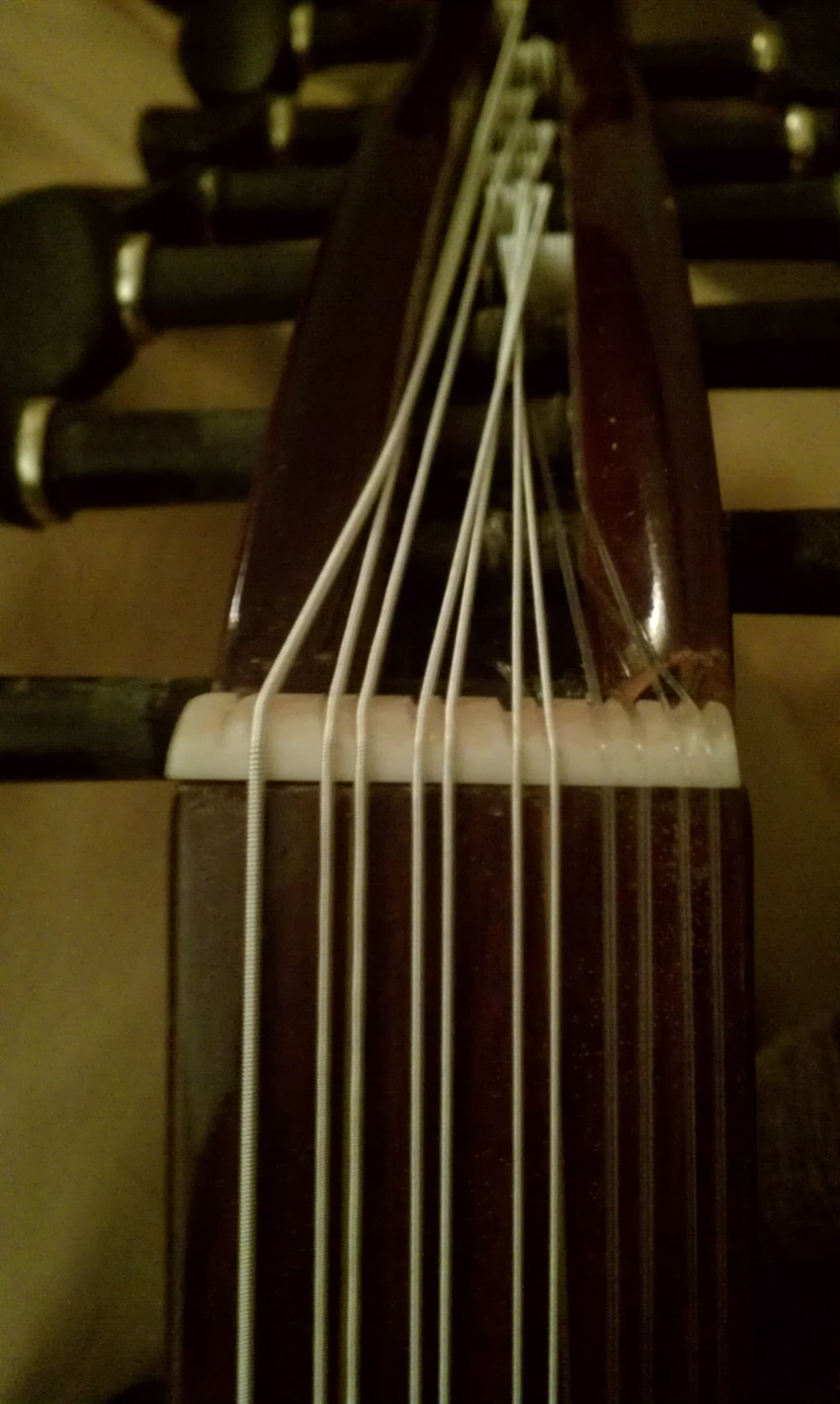

[*] posted on 1-4-2012 at 02:33 PM
More detail of the nut. The damage you see to the wood on the pegbox was on the oud when it arrived. It looked beaten to hell.

Posts: 2939
[*] posted on 1-4-2012 at 02:51 PM
Brandon may be able to help you find a better oud.
If I was stuck with that instrument, here's what I would do:
-replace the nut and cut the string slots properly
-try to remove all of the finish on the face and fingerboard.
If it's shellac (unlikely), you can do this with alcohol
If it's lacquer, you can do it with lacquer thinner
If it's synthetic, you can do it with sandpaper. Usually the tops on these cheap ouds are thick enough that there is little risk of over-sanding.
The finish on the fingerboard is particularly detrimental. It would probably be easiest to remove that with some kind of scraper. The luthiers on the forum may have better advice.
John Vergara does work on ouds and may be able to help you, though I don't know if it's worth spending much money on this oud.
If you want to trade up to a high-end oud (I'm talking $1000+), Najib Shaheen may give you some consideration on a trade. He sometimes takes ouds like this and replaces the face, nut, fingerboard and pegs, and resets the neck, keeping only the bowl and neck.
