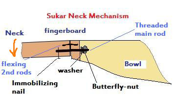

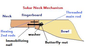

Luan, it's a standard feature of Sukars. You reach inside up to the headblock, and you find a butterfly nut. Tightening it (gently and gradually)
pulls the bottom of the neck inward towards the instrument, so the action is lowered. The range of adjustment is not as wide as on a Fadi Matta, and
with wood settling over the years can "run out of adjustment" so some filing of the mating surfaces can be needed to have full range down to 0 mm high
action, but still it's a simple and wonderful thing; it's invisible and doesn't negatively affect the structural integrity or the sound. The timbre
changes in interesting ways depending on the height of the action.
luan
Posts: 159
Registered: 11-25-2011
But if the two parts doesn't make contact, you're not losing sound there?
No, the parts do make contact, its just that there is some slight flex. The diagram is not to scale. I can assure you it works very well.
