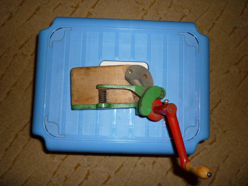

What is (was) this device used for?
I found this device on some old-stuff market. I have no idea what is it for. Can you help me? The longest side of wooden part in it is about 20 cms.

A vote for can or maybe oud case opener.... ;-)

:D No, i think it isn't. But at first sight I was thinking it is something to use in the kitchen.

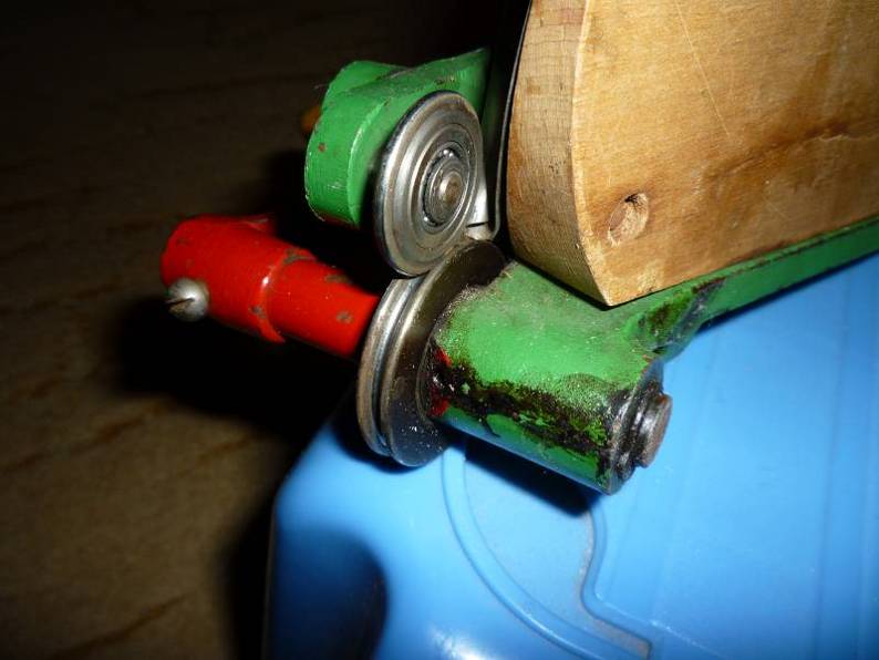

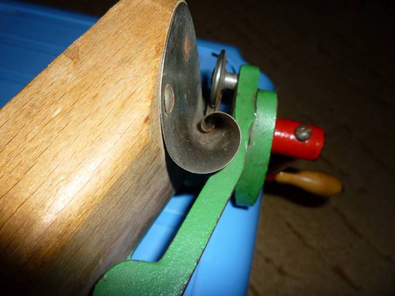

Anyway. it looks like it was designed to insert something via this metal "scroll" and and "squezee" between these two wheels, the smaller one is pushed towards the bigger one with groove. Maybe for compacting fibres into a cord? But it seems to be too small.

Well if this is a Luthier's tool (Is it confirmed that this is a Luthier's tool?), the only use I can imagine for it is bending fret wire.

Not a fret wire bender, frets have a tang to hold in the fingerboard, which would be deformed by the wheel. Not a can or case opener, because the feeding funnel would prevent feeding any flat sheet into the press. The only thing I can see to use it for is to form a U shape in a flat strip of metal. This could be used for edging or other metalwork. I can not imagine any use in a lutherie shop.
[*] posted on 1-24-2014 at 04:43 PM
I have an interest in old hand cranked devices but have never come across one like this. It is not substantial enough or of the correct design to form thin metal strips into a U section.
So what can be learned of its intended function from its appearance?
1) it is a manufactured product - relatively modern.
2) the funnel feeding the rolls is designed to provide a twist and compression to the input material before passing through the rolls.
3) the rolls are designed to pull the material from the funnel in a straight line guided by the U shaped bottom roll - the free rolling, spring loaded top roll providing the necessary friction.
The material drawn though the machine would have to be strong but easily formed into a permanent shape but what was it?
My guess is paper.
Paper twist is a kind of rope or string made by twisting lengths of paper - compressed from a width of about 4 inches (10cm) before being twisted into a relatively uniform cylindrical string - an imitation of 'Raffia' a natural fibre .
The attached images show examples of commercially available 'paper twist' that not only has a utilitarian use for tying stuff together but is also a base material for a popular modern craft - that of making decorative paper flowers and other objects.
So, the proof test of this theory would be to take a wide strip of strong, thin kraft paper, feed it into the funnel, crank the handle and see what comes out the other end!

your assumption is right :) I recently saw similar device in a local flower shop, but I totally forgot I was asking about it here. It is used to make decorative "bouquets" with "roped" edges from blotting-paper... And the lady in that particular shop told me she got her device from Italy, and she had never known a specific name for it.
