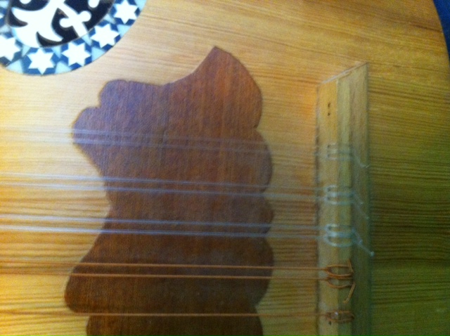

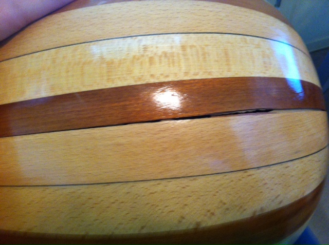

Also, I've attached some pictures because I'm not quite sure if I need some repair work done on this guy. I think there are some strings missing? Can I go get them strung at a guitar place? Theres also a crack in the base, but I was thinking about going at with some wood glue.

Welcome! It is impossible to form an opinion on the state of your oud without more, and more detailed, photos. Your oud might need work, if you show us more photos we might have some suggestions. I would leave that crack alone for now, until you know a lot more about ouds.
It is not unheard of to string an oud with 5 courses this way, but if the oud has the customary 12 pegs, you should string it with the more contemporary 6 courses, 3 being doubled plain nylon, 2 being doubled wound strings, and the bass being a single wound string as you have now. You can get an inexpensive set of strings from Bill Ostrie, the Daniel Mari Arabic set costs about $10 and is a good set. That's for openers.
