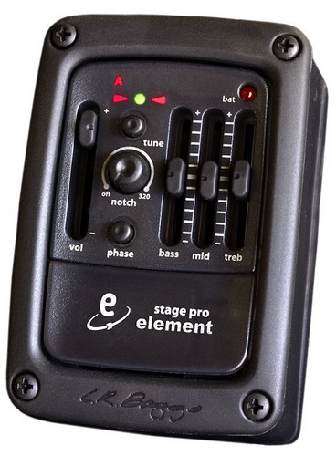

Hey oud lovers,
I started to make a thin eletric oud for travel easily.
Do you know a good preamp with 3 band EQ like this one but smaller ?! Size max with battery would be L90 x W55 x D55 ( generally the problem) ...
baggs_stagepro_element.jpg - 48kB
The depth is to big !...
Furthermore ,ideal would be a preamp with output for headphone but i believe it doesn't exist :(

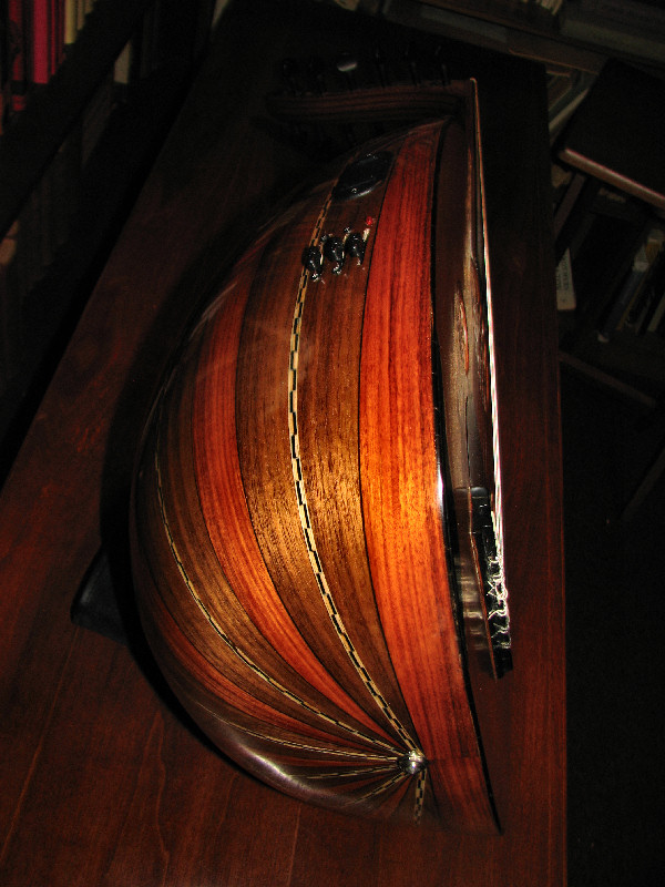

There are hundreds of models on ebay, mostly direct from China. The Artec line includes the PP-637B wide 6 string piezo pickup that is spaced right for an oud.
http://artecsound.com/acou/piezo.htm
At the moment I can't find the US vendor I got some from, and who had a pretty wide selection inexpensively priced at an ebay "store", and delivered quickly without gambling on what exactly you'll get, but look around.
Look through all their models, including the "guts-only" ones that don't have an enclosure.
http://artecsound.com/acou/etc.htm
It's worth noting that you can take the guts out of the can if depth is a problem. Shehata builds these into ouds by ripping off the face too.
IMG_1967cm.JPG - 162kB
As to quality, piezo pre-amps are not rocket science, the sound in large measure depends on the pickup, how it's matched to the pre-amp, the position of the pickup, luck, etc. If you have some skill and/or patience it's pointless to buy expensive fancy stuff, you can make inexpensive circuits like these work very well.
