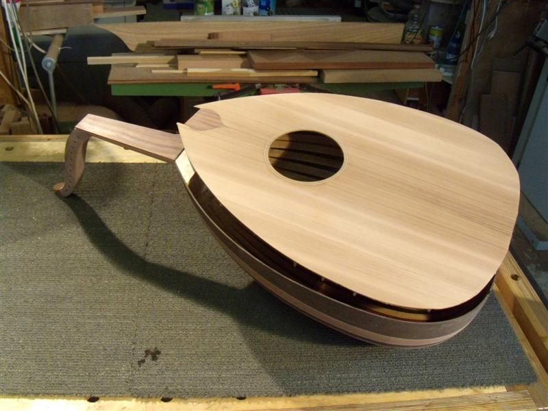

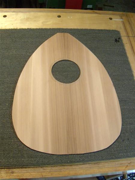

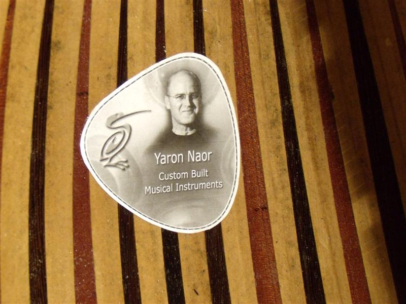

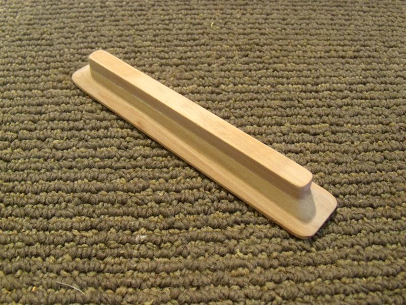

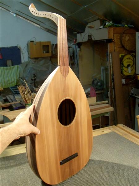

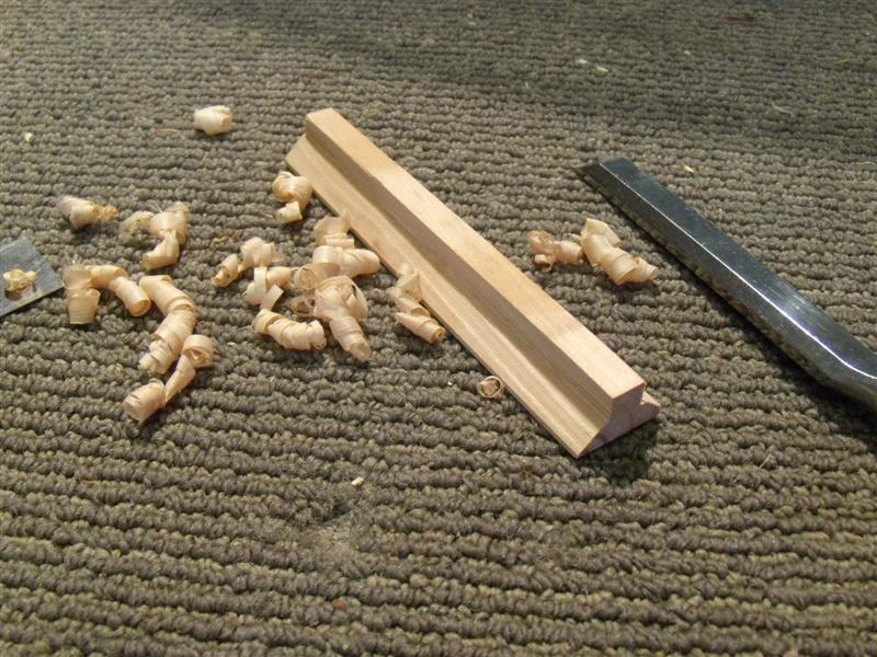

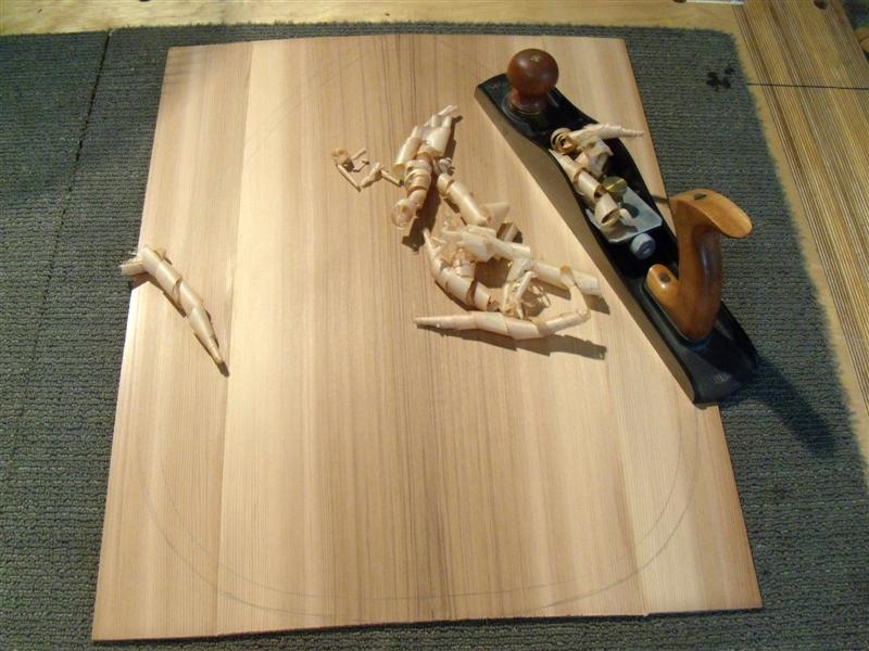

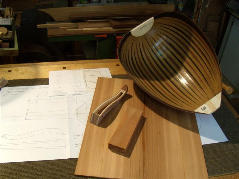

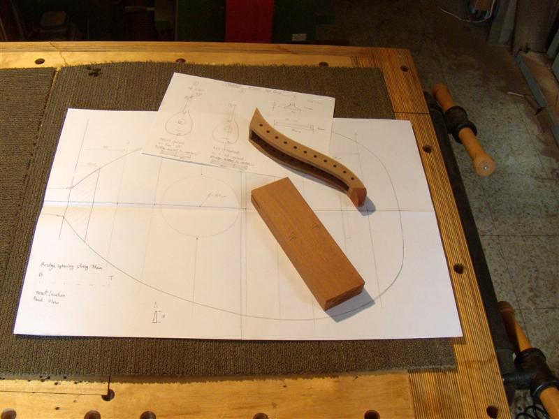

After repairing some "Nahhat" ouds, I have decided to build an Oud that will be a Nahhat style,
I used the geometrical analitics of our good friend John Downing and here are some pictures:
I HOPE that the sound will be a bit close to the real thing (-:
I found a 25 years old Cedar top...
and I designed the ticket that includes my face as the Syrian builders used to do.
Enjoy...

[*] posted on 8-5-2012 at 02:12 AM
Very nice soundboard !
Could you post pictures of the bowl.
Congratulations.

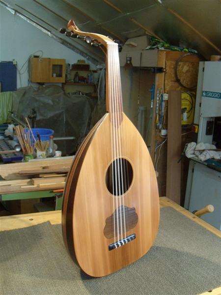

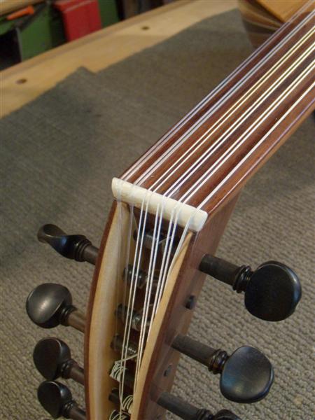

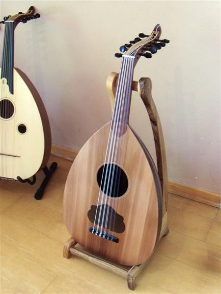

[*] posted on 8-5-2012 at 04:00 AM

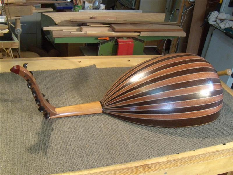

Finished, ready for recordings
Thank you all for your support
Today I put the strings on, and in a few days we will have a video!
The sound is amazing and I hope it will set on the Nahhat sound
Enjoy
Yaron Naor
DSCN5817 (Medium).jpg - 39kB DSCN5814 (Medium).jpg - 93kB DSCN5812 (Medium).jpg - 55kB DSCN5811 (Medium).jpg - 100kB DSCN5810 (Medium).jpg - 74kB DSCN5809 (Medium).jpg - 84kB DSCN5808 (Medium).jpg - 49kB

[*] posted on 8-5-2012 at 05:44 AM

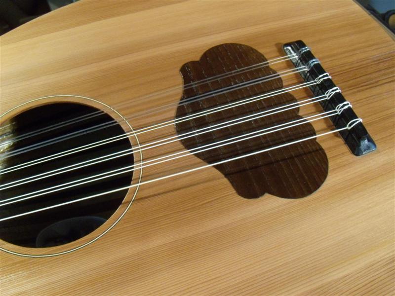

Congratulations Yaron,
I really love the very clean and perfectly executed design :applause: Is the bracing also copied from a Nahat ?
However one thing is lacking for a perfect Nahat look : the moustache :D
Dan

[*] posted on 8-5-2012 at 07:55 AM
Dan
Thanks Dan (-:
For your compliments, and yes, the bracing is the exact bracing of the Nahhat, I have change a bit the pegs-box to be more comfortable for the strings and the pegs are from Ebony
Unfortunately I don't have a mustache so the ticket stays like that (-:

[*] posted on 8-5-2012 at 02:49 PM
Excuse me !
Though nice looking oud & fine job, it did not remind me of any Nahat I've ever seen: 19 ribs, beech wood bridge, no rosette, different pegbox, ebony pegs, full neck-block, non-homogeneous soundboard ! ! What exactly did you mean by saying a "Nahat style" oud ? :shrug:
I hope the sound will meet the expectations more than the "looking".
Good luck

[*] posted on 8-5-2012 at 04:45 PM
What is a non-homogeneous soundboard?
[*] posted on 8-5-2012 at 09:39 PM
Like we see in AAAA tops. Nahat usually used HQ wood for soundboards.
I didn't find more accurate description. Excuse my poor technical language.
Thank you

[*] posted on 8-6-2012 at 05:20 AM
The reason that the reference to non-homogeneous sound board caught my eye is that all wood is a non-homogeneous material - some more so than others. So I was curious about how the sound board of this oud might differ from that of a Nahat oud.
The luthier trade today grades its wood on cosmetic considerations (as well as on some physical characteristics such as density and stiffness) - straight, fine grain, uniform colour, perfectly quartered etc always supplied in two book matched pieces so satisfying customer demand (and profit margins!). However, it is perfectly possible for an experienced and knowledgeable luthier to make fine sounding instruments using woods that would not otherwise pass muster aesthetically in today's market and by assembling them together as multiple piece soundboards.
As far as I can judge from the images posted, Yaron has made the sound board from four pieces. From some images that I have seen of ouds that are said to be Nahats, the sound boards can be made from up to six pieces and may contain some of the wildest, crooked non uniform grain that can be imagined. For example the Nahat oud recently restored by luthier Michael Cone appears to have a sound board made from six pieces (See 'Analysis of Nahhat Bracing' page 1 on this forum). Also have a look at the images of the 1906 Abdo George Nahat oud posted on Richard Hankey's website for an example of extreme crooked grain.
So could this mean that these ouds are not genuine Nahats after all?
[*] posted on 8-6-2012 at 10:25 AM
When I said Nahat, I meant Abdo; who was known as super pedant choosing the SB.
One may find some other brothers' ouds in which the maker did not pay the same attention to this part of the making. Moreover, SB have been often replaced.
None of any Nahats I've seen (and I don't assume ALL Abdo Nahat ouds) has this kind of wild spruce. None has cedar either. So when making Nahat style oud the contemporary maker should follow Nahat's footsteps in every specification possible. That's all !

[*] posted on 8-31-2012 at 09:15 PM
Well, I like it, whatever you want to call it. It has a very rich tone and good balance, a very nice job, congratulations. Now, what's with the oud in the back with the big ears?

[*] posted on 9-3-2012 at 02:40 AM
Thanks doc! I really appreciate it that you took the time to view and listen...
The oud at the back is my "OUDAR" a unique combination of a Turkish size/sound oud with a shape of a guitar and a flat back
It is easier to play and it sits good on your leg, the sound is a very special Turkish sound

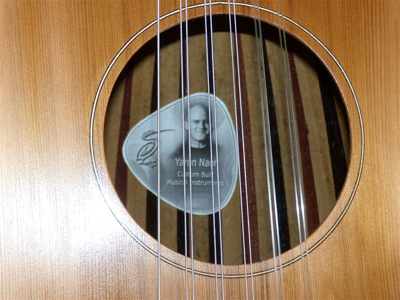

[*] posted on 9-3-2012 at 05:51 AM
Congratulations! It does have a great sound, though the automatic gain control on the camera makes it sound like it sustains forever ;-) Did you French Polish the non-homogeneous soundboard, or use a brush? Shellac or? But, moustache or not, you really should put the date, your cell-phone number and your e-mail address on the label, like Abdo did.

[*] posted on 9-3-2012 at 10:42 PM
Thanks!
I apply shellac on the oud body only, on the soundboard I put one cote of a special liquid that I make here, to prevent the wood from drying too fast (old Cedar is a drying sensitive wood) and crack, and preventing the oil from the fingers and the hand.
For sure I have put the date and my signature on the ticket!
