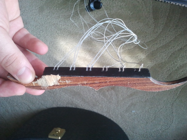

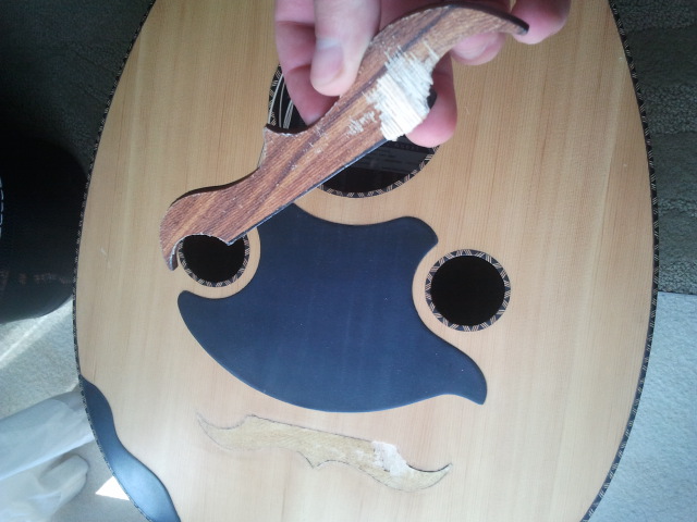

Oud bridge snapped off, advice on glue
My oud bridge came off, and I wasn't even playing it (it was resting in a temperature controlled room, at 22 C).
I think I should be able to glue it back, but would like your advice on which glue I should use.
Thanks.

if you want it to definitely stay on - and never come off again, then use some gel form super glue. Just clean up all the old glue and make sure the
bridge sits flat and flush... then apply the gel super glue to one or both surfaces, then press in place - keep pressing down quite hard for 10
minutes to be sure....

I really do not know weather glue is the right solution for fixing your Oud Bridge or not.
As you know , the wood of the face is the thinnest wood in the Oud , super glue may damage it , as fixing it in a wrong way as well , considering
that such operation requires a high precision , so that it matches perpendicularly stings .
Personally , I would ask a oud repairer for advice .

super glue may damage it??? do you realise that in istanbul most of the best luthiers there use super glue extensively in their oud making - gluing
bridges, necks, purfling, pegboxes, and many other parts with super glue. You might feel more comfortable with the name CA glue. In turkey they call
it "japon". This glue does not damage wood at all... rather it fills the pore permanently and enhances the wood - however that problem with CA glue is
that you can not reverse it... if you make a mistake you are stuck! It is permanent.
turkish luthiers also make extensive use of contact cement! I have heard prominent guitar and violin makers say that contact cement has NO place in
luthiery...![:shrug:](./images/smilies/shrug.gif)
Strangely, in my time in istanbul i almost never saw any luthier use white (or yellow) wood glue, which is unquestionably the most common glue among
guitar makers.
If you are not confident in gluing the bridge then take it to a luthier.

I glued back a bridge with Titebond Original two years ago, and it's still ok.
In your case, make sure to gently remove the old glue, you may degrease the bridge before applying the glue (depend on the wood, yours seems to be
rosewood). You'll need special clamps to maintain the bridge in place.
You can check perpendicularity to the centre line of the soundboard and the neck prior to do the job, with a long ruler and a square.
good luck

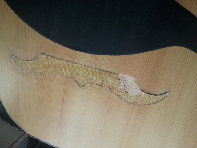

How do I remove the old glue?
Hi Edward - where is contact cement used extensively on modern Turkish ouds? Just curious.
I dunno, it looks to me like removing the old glue could be a nightmare job. It looks like they didn't clamp the bridge very well. And there's that
wood chip in the one place where there was pressure.
I'd hazard that Edward's approach makes sense. Test the old glue layer, see if it's hide glue that's removable with warm water. If it is, get it off.
If it's some sort of plastic glue that won't come off that way, or with a solvent, it will probably hold, so you could just clean with some alcohol,
put the CA glue on both sides, get it in the chip area too so the chip bonds in place. No problem lining it up then. You probably won't need a clamp
if you can apply pressure from above and inside the sound hole for 10 minutes.

If there is a residue of titebond, nothing much will stick, including more titebond. Most glues will soften with heat, so you can use a heat gun on
low or a hair dryer on high, carefully now, (do not overcook the face!) then scrape off the softened glue with a putty knife. Continue with moderate
heat and rub off the remaining glue with steel wool, only use fine grade, 00 or finer, I like 0000. Cyanoacrylate (japon, super glue) does have a
solvent that will soften it. The joint is most important to get a good fit - lap sand the bridge - hold a piece of 60 -80 grit garnet sandpaper on the
face, grit side up and rub the bridge back and forth in the direction of the neck, only a little way and only a little pressure, let the grit do the
work.

without any question you MUST get rid of all old glue... and make sure you have a PERFECT fit before gluing.
3 problems with titebond:
1) plastic type glues do not cure to a brittle hardness so do not transfer sound as well
2) water based glues will not last as long and be vulnerable to humitidy
3) slow drying glues need very special clamps.
CA glue solves all these problems BUT - it is a one way ticket so only do this if you are really sure you know what you are doing

If you like a glue that grips tight immediately why not try good old fashioned hot hide glue - strong, fast setting, non toxic, reversible, shrinks
when it cures (to make a joint even tighter) and is relatively low in cost? Also, in its dry state it has an infinite shelf life. Requires use of a
hot iron to remelt the glue in order to make long joints like soundboard or rib joints - a technique akin to making a soft soldered joint in metal.
For rib joints the old way was to temporarily hold the joint together - step by step - with glue soaked paper strips scorched in place with a hot iron
(scorching of hide glue causes it to set instantly and at the same time remelts the underlying glue in the joint for a perfect fit). When the bowl is
complete, the paper pieces covering the bowl exterior (and temporarily reinforcing the bowl) are then scraped off as part of the finishing process.
For straightforward (but accurately made) simple joints like neck or bridge use high bloom strength hot hide glue that will gel within a matter of
seconds - the joint held together with hand pressure for a few minutes to be sure. Speed is of the essence in these cases. Forget about it, however,
if the joint surface has been previously contaminated with modern synthetic glues.
