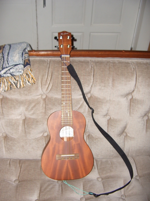

[*] posted on 8-24-2012 at 09:42 AM
Thought I'd dip my feet into this wonderful discussion with some info from the ukulele world. Due to the rising cost of high-grade koa (which is the traditional uke wood) some manufacturers have been building ukes with alternative woods, with fabulous results. I have a Ko'olau tenor ukulele made of 'Ula wood, both body and soundboard, and it is profound. If I had unlimited resources I'd commission one of the luthiers on this forum to build me an oud with 'Ula as the soundboard, and one of the other alternative woods for the bowl. That will have to wait, but in case any of you are interested, here is a link to Ko'olau's wood selection, where some of the alternative woods are listed:
http://koolauukulele.com/woods/
I've attached a picture of my uke, although the image does not do the deep, rich red of the 'Ula wood justice. Unpolished, it is still truly a sight to behold. And sound wise, it is as buttery as they come.
Jack
ula-wood-uke.jpg - 235kB
