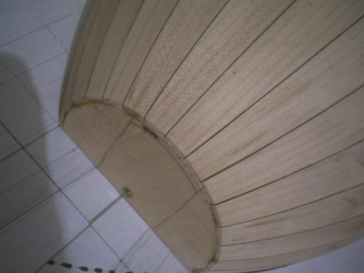

it's for this kind of veneering that I need it... not a whole body black...
9.jpg - 34kB
