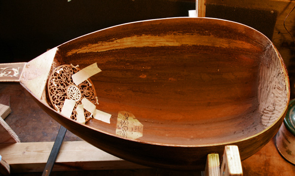

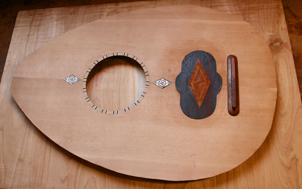

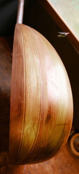

This project started with 2 missing ribs, no face at all and a broken peg box. The soundboard is using German spruce bought from Vitali Imports in LA in 1968, when it was already 10 years old. The braces were gleaned from the back supports of a 100 year old upright piano. I hope it sounds as good as it looks...so far so good.

Interesting to see the carved out neck and end blocks. This would seem to allow a greater surface reinforcement area of the ribs without increasing weight or reducing bowl volume or adding significantly to the joint surface area below the bridge?
How does the neck block carving look Richard? Could you post images for information?

[*] posted on 10-16-2012 at 07:40 AM
The neck and tail blocks are larger than usual, and the scooping out is left with the gouge tool marks, not smoothed out at all. I believe it was done to maximize the volume of the bowel for added bass reflex, as well as to provide more support surface area both for the ribs and the soundboard. Another benefit is to reduce the overall weight of the oud. There is more surface to support the soundboard below the bridge at the tail block which may be the most advantageous characteristic. As the face is directly attached to a wider surface of the tail block, a larger area of the soundboard would be excited by the torsion of the bridge, rather than dissipating in the unsupported area outside the tail block surface.
I am not able to provide a detail photo of the interior as I just glued the face on.

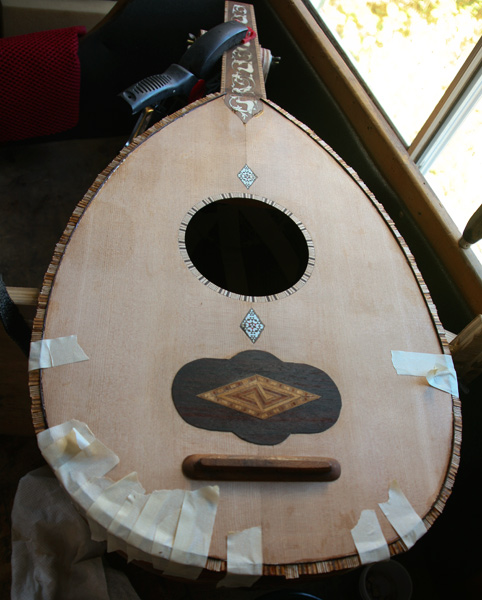

face mounted, beard and tiles installed, almost ready for string test! I'm quivering with anticipation!
