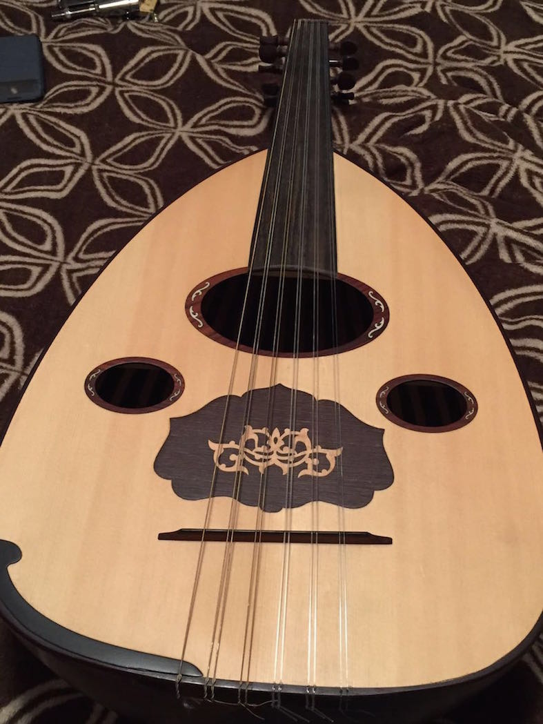

I tried tuning it in to standard arabic tuning cc, gg, DD, AA, FF, C but the high cc course on the first string sounded too dull or low. I tried moving it (cc) up an octave and it sounded too high and was almost going to snap. I quickly changed up the tuning to a high arabic tuning which appeared normal in terms of pressure and sound "ff, cc, gg, DD, AA, F".
My questions are:
1. Most online tutorials and lessons taught on internet (free and paid) are in the standard arabic tuning. If my oud is tuned using high arabic tuning, would that through me off course?
2. Is the high arabic tuning the right tuning for my oud?
3. How do I know which strings to buy for future replacement

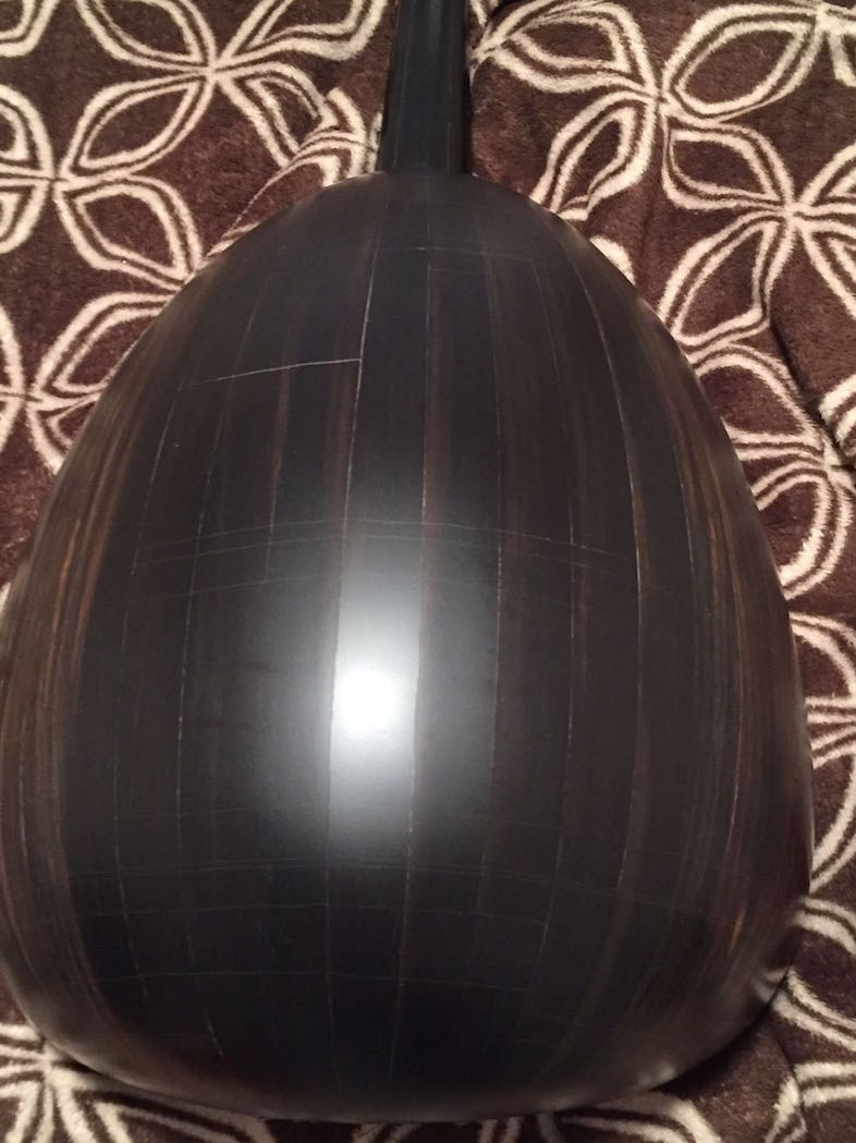

6. Do the cracks look worrisome? the oud was bought used.

1) it depends on your abilities to mentally transpose. you can either play one string lower or mentally call your string by names that are an interval of a fourth lower. But you not compelled to use the string that are now on the oud.
2) your Floating Bridge model oud looks like the kind that is usually played in high F tuning. But the way to know how to tune the strings that are on there now is to measure the strings with a micrometer. If they correspond to the diameters of strings intended for F tuning you can safely tune these particular strings to F tuning. Websites that sell oud strings often give diameters and you can ask the proprietors, some of whom participate in this forum.
But there is no reason for you not to get a set of standard C tuning Arabic strings and tune them to the tuning you have found in the tutorials. You cannot harm your oud by tuning it lower.
It is more usual for a high (F) tuned oud to have a double bass course. the photo seems to show a single course. Does your oud have 11 or 12 pegs? Is there a double or single slot for the sixth course in the nut?
Also without knowing the diameters of the strings it is hard to know what tuning for which they are intended.
3) By obtaining the strings intended for the tuning you want to use. In other words, there is a direct correspondence between a set of strings and a tuning. There is an indirect correspondence between an oud and a tuning. Decide on a tuning you want to use and get a set of corresponding strings based on the "scale" length of your oud. "Scale" in this case means the length of the vibrating string between bridge and nut.

6) I see some scratches on the back, no visible cracks. If there are any cracks they should be repaired by a qualified luthier.

My oud has 11 pegs. Also, the nut has two positions for the sixth course. The placement to the extreme left is left open. what conclusion does that draw?
One can conclude that your oud has 11 strings. Do I pass?
Just kidding.
There is no reason that there should be 12 slots in the nut if the oud has 11 pegs. There really is no conclusion to draw here (other than the oud was likely made in a factory the slots all nuts with 12 slots regardless of the oud it's going on). You can still use either tuning, but you'd need a different set of strings to use the lower classic tuning.

....6. Do the cracks look worrisome? ...
Cracks or open seams in the back are common but should be glued shut. Hide glue is best, but since these joints don't need to be repaired, you could use any wood glue, even epoxy, but not white polyvinyl or cyanoacrilate (crazy glue). If the crack can be pushed shut and/or aligned, do it then wipe the excess glue off the surface and tape it in place with - masking, duct, whatever. After the glue cures the surface can be cleaned with alcohol to remove dirt, or acetone to remove tape residue..
