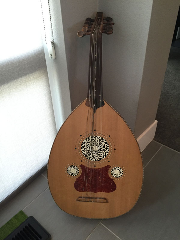

I'm obviously new to the forum. I am moving and have an oud that was my father's that has been in my basement. It had a cracked neck and would need to be repaired to be played. However, I know it's quite old and may still have some value. Can anyone help me out? I have attached a few pictures as well. Thanks so much for any input you can give! I have a few buyers interested but have no idea what to sell for. I have no idea where to find a serial number as well. I looked everywhere...
IMG_2783.JPG - 82kB

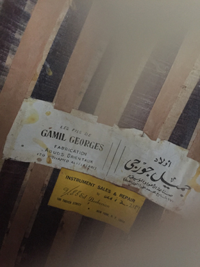

What you want to do it take a photo of the inside label. This is behind the front rosette. If you look in good light you should be able to see it. Taking a photo of it is hard but possible.

I did! Thanks. Here it is.
IMG_2789.jpg - 90kB

Les fils de Gamil Georges - Egyptian, probably from the 70s/80s. I'm sure someone else can confirm.

Georges was a good maker. The oud is potentially worth some decent money, but it has to be evaluated by an expert. It's often the case with old ouds that they need many expensive repairs in order to be usable.
This appears to have been repaired at one point. An evaluation of the previous repairs would help determine the value also. It looks like it was repaired by "Berberian" in NY, though the pic is a little hard to read. The pickguard appears to be replaced, and possibly the bridge. If the soundboard or braces are not original, it may be worth less. If it sounds great, it might be worth more.

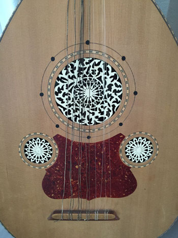

If I was to guess, the whole face seems to have been replaced, which would normally lower the value substantially unless it was really great.

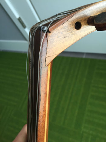

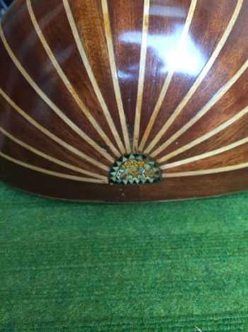

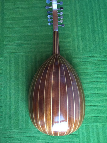

Thanks! I'm in Denver. And I will attached some pictures. Hard to attach high quality pics with the 500kb limit.
IMG_2785.JPG - 46kB IMG_2784.JPG - 65kB IMG_2786.JPG - 14kB IMG_2787.JPG - 62kB IMG_2788.JPG - 66kB

This oud, restored to good working order, would probably be worth $1000 to $2000, entirely depending on how it sounds and feels. If you are selling over the internet, that means it will be the low end of that estimate; since the buyer cannot evaluate it in person, they will have to assume the worst. But most people don't even want to part with $1000 for an oud that might be a stinker, so expect to take a long time to sell it. Since it appears to have already been substantially modified, it doesn't even have much 'collector' value, whatever that might have been.
To clarify, an undesirable restoration will actually lower the value vs. leaving it alone, since the buyer must now undo the previous 'repairs' (if even possible).
I'd expect this oud to sell for about $550 in this condition. Maybe someone would pay a bit more, maybe not, but it has some vintage value and appears to overall be in decent condition, aside from the broken pegbox. With the better picture, I'd say about 90% sure that the soundboard was replaced, along with the bridge and pickguard. That means it's really not a "Gamil Georges" anymore, but at least 50% whoever replaced the soundboard (which creates most of the sound). Since the repairman isn't a well-known luthier, it's hard for anyone to predict what it will sound like. It also looks like the pegs and nut should probably be replaced.

This repair is simple and cheap. The crack is very common as it is the weakest joint on the whole oud and fails easily if the oud is dropped on the peg box. You only need to spread the crack slightly and apply some wood glue into the open joint, spreading it around the crack with a small brush or a strip of paper. Then close the joint with a small clamp or even by holding it closed for minute or two until it sticks, and leave it fr a day or two to cure. I would charge $25 to do it, but the shipping cost would cost about twice that much. The value of the oud would increase substantially for this simple repair, I'd advise you to do it, even if you don't keep it. If you are not comfortable doing it, take it to any music instrument repair shop, they should repair it for no more than $50, it really take 2 minutes of work.

Richard, I find it hard to believe that you can so confidently say this is a $25-50 fix with only these photos as a guide. If the interior block also detached, it is a much more involved repair, as I'm sure you know.
Even so, I don't really know of any luthiers that will do even the simplest repair for much less than $100—perhaps it depends where you live.
I also think that "any repair shop" is not good advice—In my experience, a substantial portion of repair shops really would have no idea how to correctly fix an oud. Some of them would tell you this up front, but others would go ahead and try, and then you end up with a bad repair that needs to be reversed aside from the underlying issue.
I guess it could be worth a try. My initial comments were based on his original description of "a cracked neck" with no photos. If the damage is not severe it's possible that it could be repaired more easily.
My general opinion is based on my experience that an old oud, stored in a basement for years, with some obvious damage, is almost certain to have a number of significant issues, and the best approach is to leave the restoration in the hands of the person who will play the oud. I'd be very surprised if a small crack was the only problem with this oud.
A closer inspection of the label reveals that it's the sons of Gamil Georges, not Georges himself.

I based my estimate on the picture of the peg box/neck delamination. This failure requires some glue and a clamp to bring the parts together. Altogether it is a 5 minute job. Of course if there is other damage it needs to be examined, but I see no damage to the back or tail or face, so it is possible that the broken peg box is all that's needed to get the oud back on track. Any wood glue and a simple clamp or even a held by hand with some quick setting glue like cyanoacrilate formulated for wood (crazy glue) would work fine. My minimum charge is $25, I think $100 is a rip off for 5 minutes work.

Gamil George (first G is pronounced like "go, get, graet" etc.; while George is pronounced like any other George) worked in Cairo until 1965 when he passed away. His sons took over, but couldn't maintain the great reputation of their late father. They seem to have thought that they can continue running the workshop hiring the same master's apprentices, but soon discovered how wrong they were. The business crashed down very rapidly, so they sold it, alongwith with their father's trade mark name. Since then, the workshop continued to make ouds under the name of Jamil George, but the name was the only common thing with the late master's ouds.
I have visited this poor workshop several times in the past, and each time I ran away very quickly, mourning the loss of the legend. The old guys there continued making the same 100 pounds ouds they made 30-40 years earlier. What a pitty !
I came across some of the sons' ouds when they were still running the workshop. They had farely good bowls, but the soundboards were total wrecks with zero sound. Contrary to the popular belief that replacing the soundboard may degrade an oud, replacing this particular soundboard may have upgraded it !

I wouldn't be surprised. Though if this oud is as old as it seems, it may have been relatively shortly after the sons took over. I don't know if that's better.

FYI oud repairman Berberian in NY is almost certainly Edward (Yervant) Berberian, father of the renowned oudist John Berberian.
Edward Berberian was born in Kayseri, Turkey and was an amateur player who repaired ouds in the back of his dry cleaning store in NYC.
I dont think he really made ouds, mainly repaired them.
