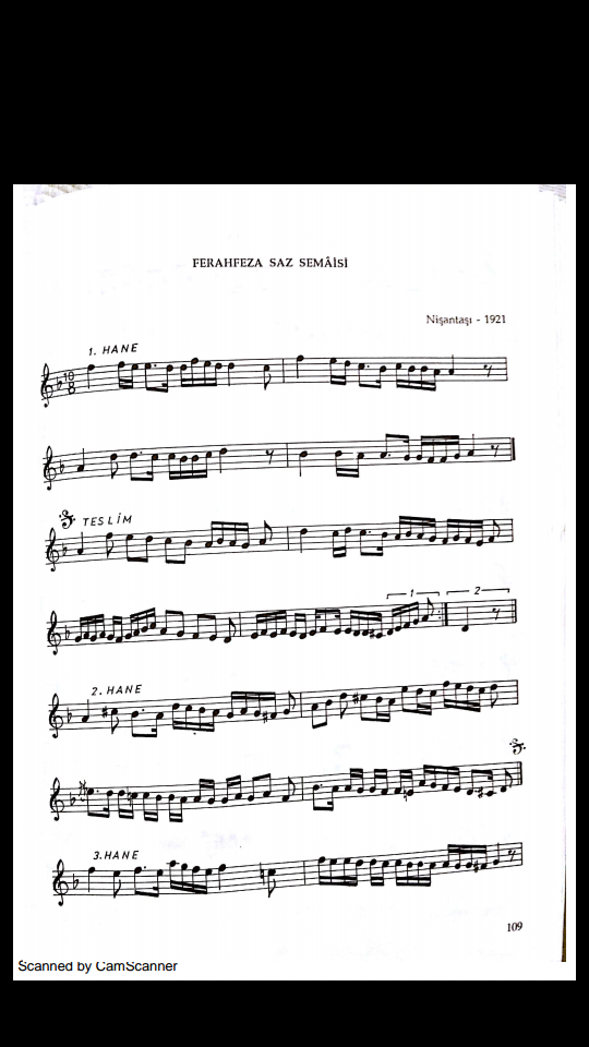

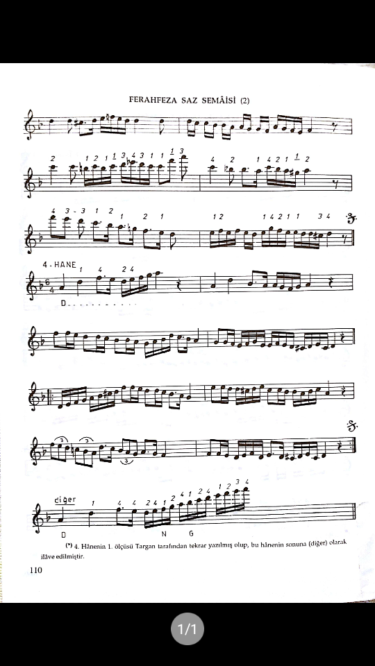

[*] posted on 1-1-2017 at 10:59 AM
Hello
so here is pictures for the original score proposed by Serif Targan.
there is indeed those high register sentences in the 3rd and 4th khane.not surprise the score of Jamil Bashir is correct toward the original..he was student with Serif Muhieddeen Targan.
Note the sentence proposed by Jamil Bashir to open the 4th khane appears written at the end of the original score as " diger ". I don't speak a word of Turkish but I bet the note at the end of the page,and the " D..... " refers to this sentence as a variation for the 4th khane
So one have better to begin in Bb if he wants to play it as it was composed if his oud is tuned in C
And all those also intersting to remember us to refer as much to the origin source to learn a new piece or to its original culture to study a new maqam
Best regards to all
