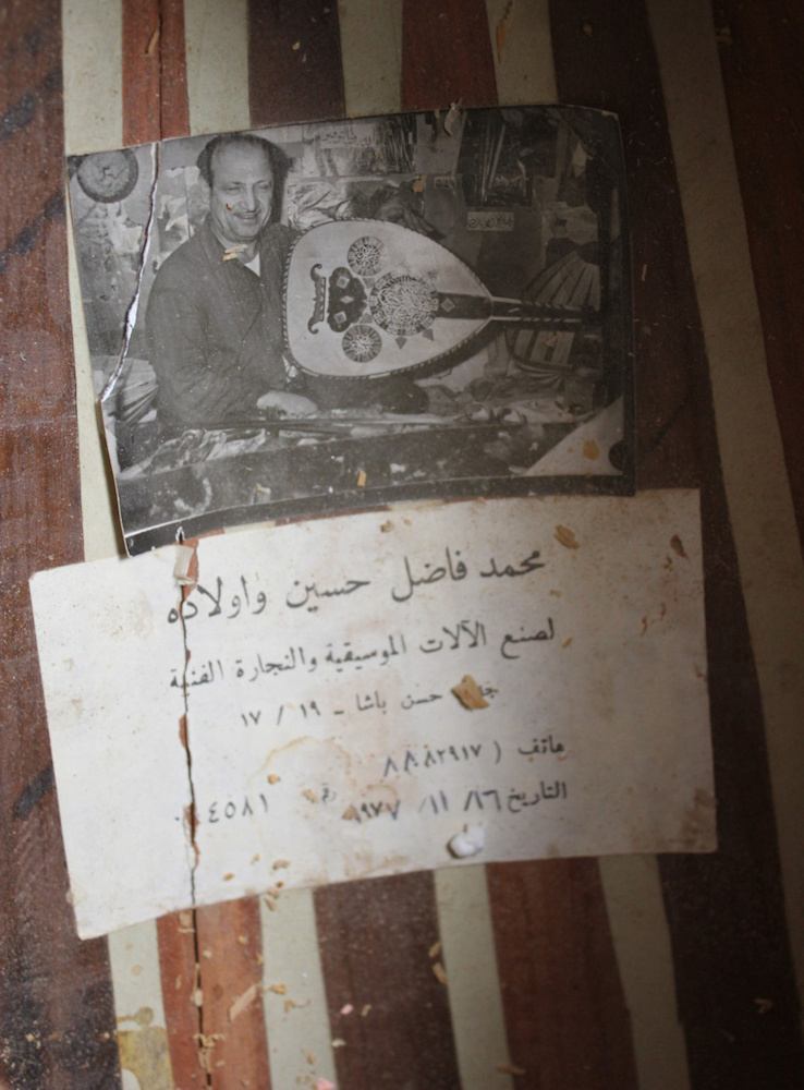

I am really wondering about a few things:
  1. the pictures from the backside show 2 different instruments
    one has 15 ribs & theother 17 or 19 - the picture quality is so bad to be able to count it exactly
  2. I am wondering about the label:
    why is there a crack in the paper not following the rib connection, while there cannot be seen any crack in the rib?
    This happens as it can be seen in the added pic of a repair I once did.
    The number may correspond to the year.
  3. I have pictures of over 55 Fadhel aouds, but none of them has such a bad quality:
    1. as Ronny said the string fastening was applied later and is a bad workmanship, not Fadhel did it
    2. the positions of the soundholes are absolutely crazy
    3. the size of the pegbox is for me not typical for M. Fadhel
    4. I am not shure M. Fadhel did make open soundholes in 1975 - are there any informations about that? would be interested.

    2. Dear Matthias,
      Over the years, I came to care more about the oud built itself. Turns out, the old oud makers didn't put much attention into their labels. Faking the label is by far the easiest part in this scheme.
      The point I made was regarding the oud design and many many parts of the oud. Just a couple of things that stand out as "screaming fake" are the string tie block at the bowl base, and the lack of symmetry of sound holes.
      The late Fadel never made such poor (lack of) designs!
