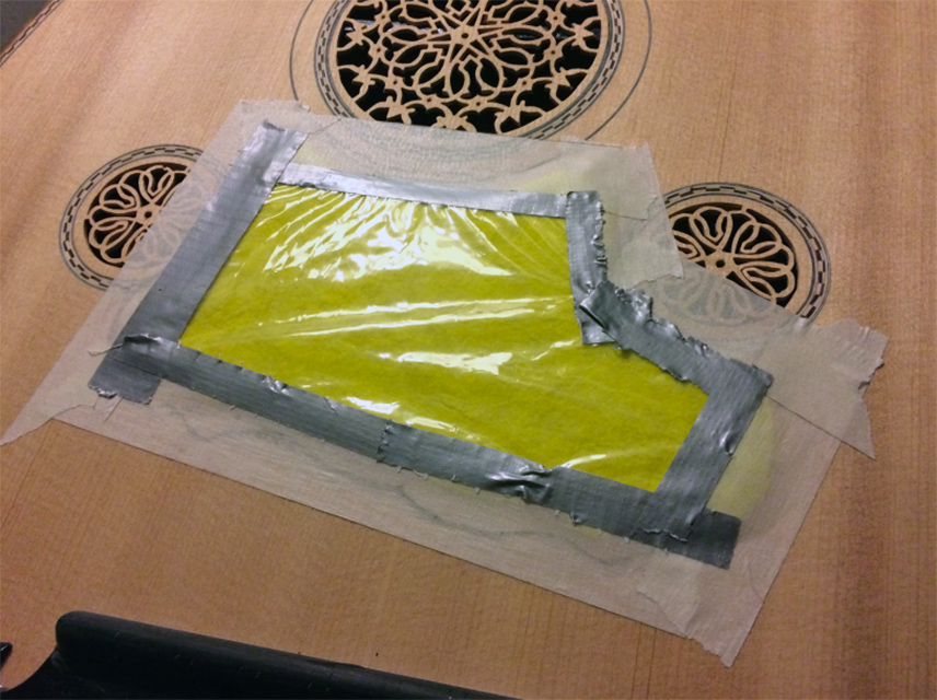

For the first 2 options I would plce a slightly wet cloth over the pickguard which should have the same size and which will be covered with a plastic and would leave this for 1 day. So both glue will swell and in the best case you only have to go with a spatula between pickguard and soundboard and can separate them.
I always avoid using a hot iron contacting the soundboard, as this is dangerous. In this case the iron is bigger than the pickguard and you have the risk to touch the soundboard with it, and also you probably make the soundboard hot and try with the risk of cracks.

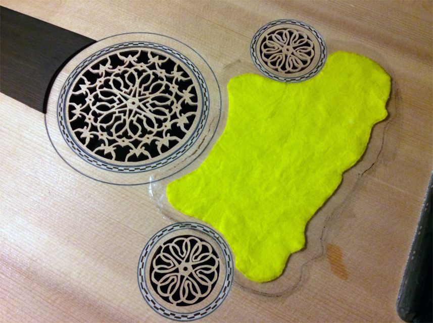

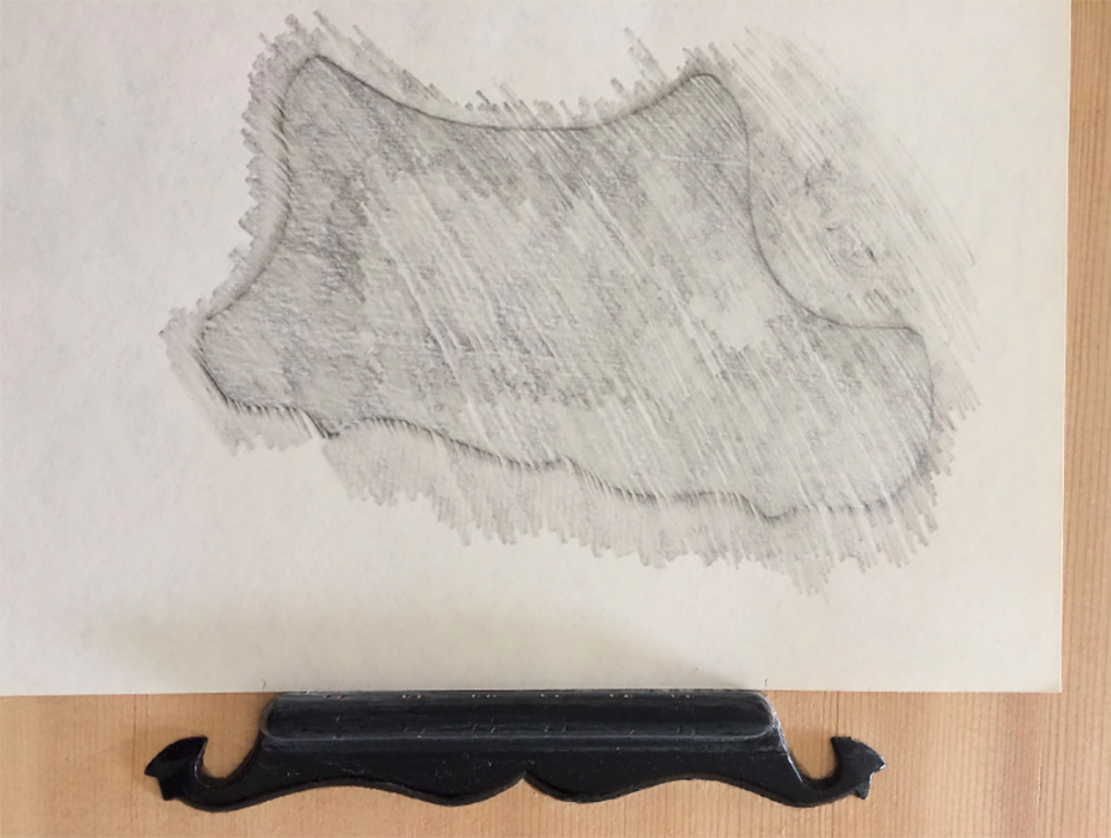

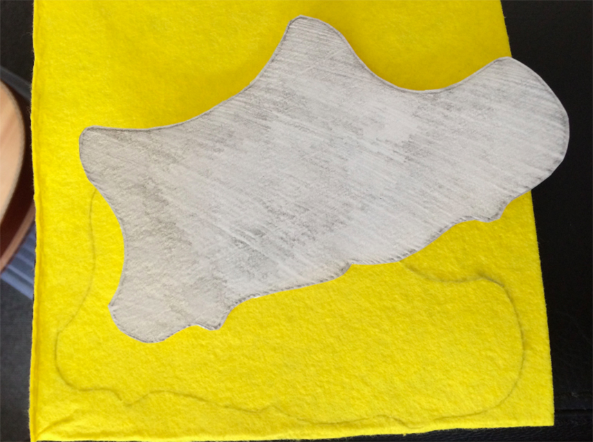

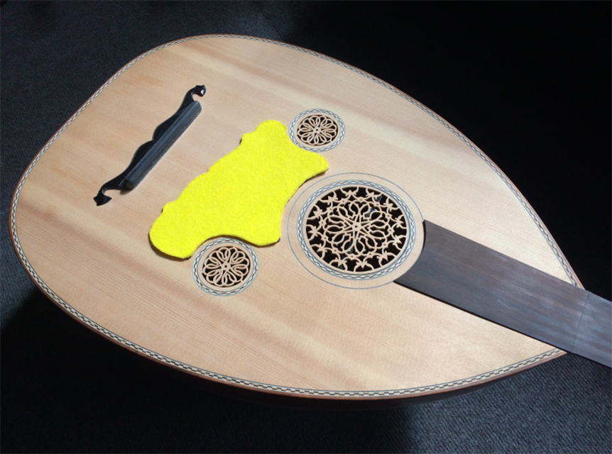

Thanks for the great information guys, very much appreciated! Trying Matthias his method first, if heat is required after the 24h damp cloth I will carefully press a heating iron on the thick sponge-cloth. Posting detailed photo's of every step I make here for other tinkerers.

[*] posted on 4-7-2017 at 02:41 PM
It's on there for 48 hours now. Will extra giving it more time (until tomorrow morning with better light) help or will it start drying out the glue again after more than 1 day as you first suggested?

I had not checked it yesterday when I wrote that, but I did this morning! The wood veneer had started 'bulging' slightly in some parts and the glue on the edge of the pickgaurd that was sticking out (brown tinted) was soft and could be scraped away easy around the edge. Getting anything underneath the edge was however not possible yet.
I put it on again after dampening the cloth a second time to see if 1 extra day will help. I don't think this is Superglue. It is a Sandi oud, not sure what glue they use, I will contact them while I wait.
