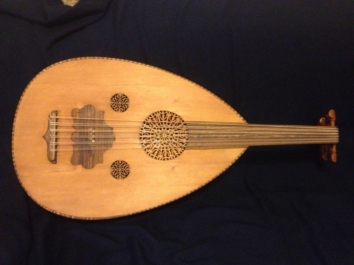

Here is an authentic Hayek oud, also with a replaced fingerboard but otherwise original.
Looking at it, I also notice that the purfling is very different, both around the soundhole and around the soundboard.
None of this is conclusive—this instrument is from the 1920s or 1930s if I recall, and he could've changed some things. But it all suggests that the oud listed for sale is not totally original, and we don't know the extent to which it was changed. It may be a wonderful instrument, but it seems to have at least a few modifications over the years.
