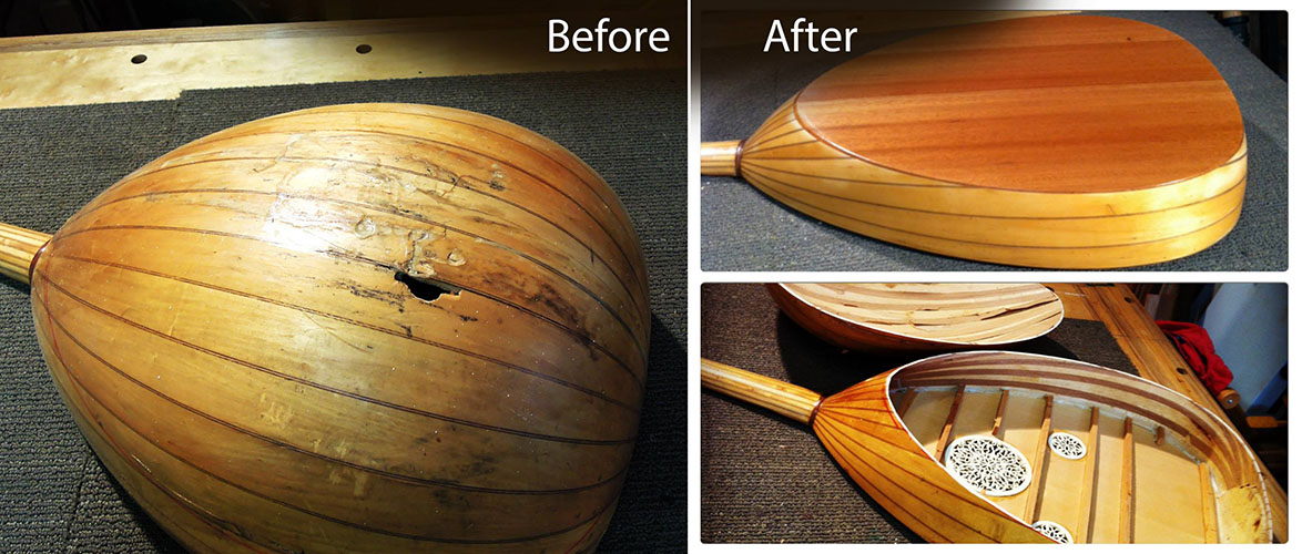

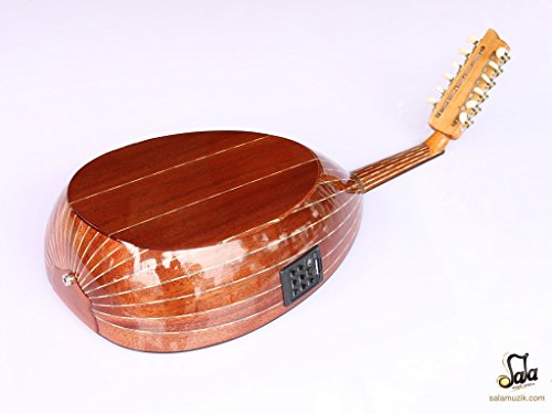

I have a problem with my right shoulder since a long time. That's why I'm wondering if I could cut my traditional Turkish oud to a "half-model" to reduce the body size by 5 centimetres. (bodywork attached below)
I tried one and it is realy more ergonomic with pretty good bass.
Do you think it is possible to modify ? Somebody did it ? Advices ?

I think it's possible would not be too complicated actually. Trace the outline and cut with a Japanese saw. Plane the opening so that it is very flat. If you have removed the rosette you can go in and install little pieces like in flamenco guitars (peones) to seal the back. I would also put a few cross braces on the back.

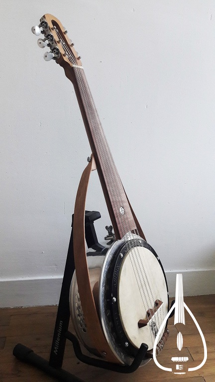

Same shoulders problem since long time. Now I play more my arabic cumbus than my turkish oud. Sound is very close, same playing, and very ergonomic because the body is small.
Here : https://www.youtube.com/watch?v=A_fNcvONZT8

I have made it 2 years ago
tnx

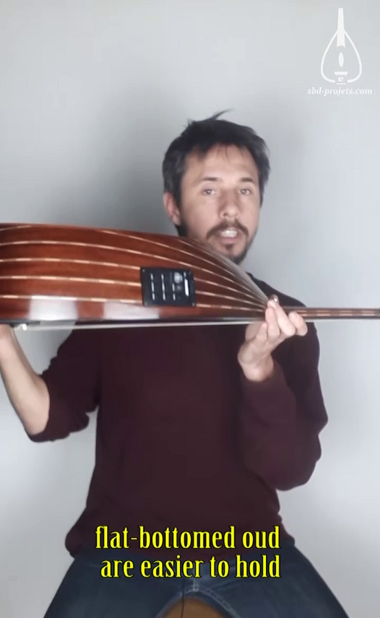

Hello
I give suite about this special story ...
Attached my last acoustic oud half body cut. I invite everybody to try this kind of acoustic oud. So confortable :cool:
The full video here
https://www.youtube.com/watch?v=NXaLAFXRQD0

Hello Sylvain
I missed that you ended this project successfully. Congrats
So how you feel the sound ? Do it changed so much,any record of before /after that may be shared ?
The idea is great in a matter of ergonomics.

Hello suzidil...
Woow many weeks later sorry !
Well I didn't cut my acoustic oud because I sold mine for same price than another model already cut. Not crazy new instrument but with some good advantages. That s why I bought it and updated it in several details.
I would like to find same with good woods good soundboard etc ... pickup is pretty good
Here https://fr.salamuzik.com/collections/nouvelles-arriv%C3%A9es/Produit...
Visit my channel youtube to listen mine.
