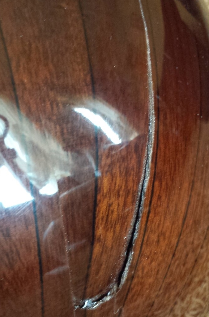

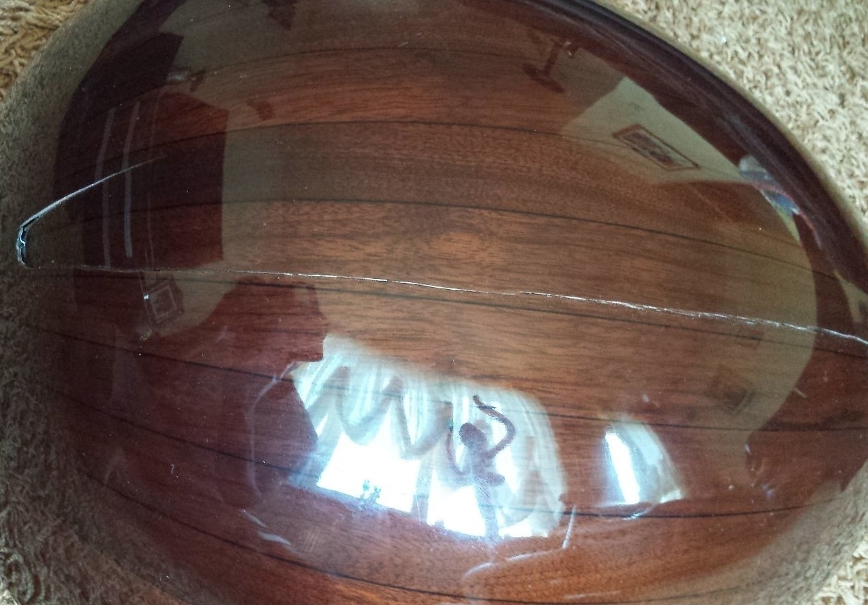

I've got an ugly crack on the back side of my Ud. Please see the attachments for pictures.
I have got 2 specific questions regarding this:
1. After pushing the crack back from the inside, is it possible to only paint the cracked area exactly the same color as the rest of the back of the Ud in order to hide the crack? Or does the whole back of the Ud need a new finish and paint because only painting the crack would never give the same color?
2. I heard that after sandpapering the whole Ud, painting it again and putting it in the oven, the sound would be even better than before. Is this because wood gets thinner during sandpapering and thus it would resonate more?

If this were my Oud, I will just fix the crack with glue and some sort of clamping (after push it back in to place). No need to refinish etc... It is only cosmetic and on the back of the Oud, and would not affect the sound. Refinishing the whole Oud is a big job might actually ruin the sound of you change the thicknesses randomly. My free advice :)

Thank you, I wanted to have it cosmetically pleasing as well.
But I wanted to know if it's possible to hide it only by painting the crack exactly the same color as the rest of the back. Is achieving the exact same color possible?
The back of the oud is not 'painted.' That's the natural color of the wood, it hasn't changed. The clear finish is cracked, which obviously shows the lines where it is cracked. How easy that is to fix cosmetically depends on what finish was used originally.
Shellac: relatively easy, the solvent is alcohol and it's just a matter of applying more and polishing it out. It takes a fair amount of skill to get it perfect but it is possible.
Lacquer: a bit more challenging but new lacquer will melt the old lacquer and it just has to be sanded and buffed out to be even.
Most other modern finishes are nearly impossible and would require stripping the entire back and refinishing. This wouldn't be advisable, as it would require a great deal of care to avoid further damage.
You can test the back with solvents in an inconspicuous spot:
alcohol=shellac
acetone=lacquer
No, this is insane, don't do anything like that. I don't know where you heard that but it's nuts. Randomly sandpapering the oud would likely make it sound worse since it would end up not being even, and would also likely make the face weaker.
Putting it in the oven is crazy, it would melt the glue and cause the whole oud to fall apart.

Further, the crack is in the bowl and the wood, not just the finish—this should be fixed by a qualified luthier.

You should heed Brian's advice - it's 100% correct. If you just woke up one day, and the back of your oud looked like that, then the back has serious problems and needs to be fixed by a luthier who works on ouds. If your oud was damaged in a fall, or something struck it, then it needs to be fixed by a luthier who works on ouds. There is no question that your oud needs qualified professional help. Best of luck.

Excuse my lack of knowledge which caused me to use the wrong terms. I got this info from my luthier but I translated his words the wrong way. I thinky luthier indeed meant stripping the back of the ud instead of sandpapering. Perhaps "oven" is not the correct term either.
I'm really curious regarding this. Why exactly is it nearly impossible for modern finishes and would require the entire back to be stripped?
From what I understood from my luthier, the finish also has a gradient of color. It contains very fine sawdust and in combination with the finish this gives a gradient. Please correct me if I'm wrong.

My question from this is simple, why is it actually not possible to make it the same color, as Brian Punks also pointed out ("nearly impossible")?

It's possible that the finish has some color added to it in some way, or that the wood itself has been stained slightly. The wood looks like a natural color so this wouldn't be my first guess, but the pictures aren't great so who knows. If the finish or wood had some kind of dye, then yes it would probably be impossible to match the color. Another possibility is that the wood has been grain-filled, which may contain dye or sawdust particles as well, altering the color of the wood's pores.
Clear finishes do influence the color, in the same way that getting wood wet changes the color; i.e., a finished piece of wood isn't the same color as an unfinished piece.
A luthier isn't going to guarantee making it the same color as an unknown preexisting finish simply because there are far too many variables to make such a guarantee. If nothing else, most finishes are UV-reactive and will acquire a slight (or pronounced, depending on the composition) yellow/amber cast over time, so a new finish will be clear and an old finish slightly yellow, causing a mismatch.
Quote:
As for color gradient, please look it up.
Not directed at me, but you might want to rethink such a flippant response when you are asking questions to which the same answer might be proposed. There are a lot of resources on the internet about instrument finishes, and even more about wood finishes in general.
I didn't suggest that it was nearly impossible to match the color, I suggested that some finishes are not possible to patch. This is due to the chemical composition of most modern finishes, which is something you certainly could look up if you are curious to know exactly how the chemistry of modern finishes work.
A simplistic short answer is that, unlike shellac and lacquer, the chemical processes involved in hardening/drying a modern finish are generally not reversible with solvents so a dry finish cannot be mixed with a new finish seamlessly.
Modern finishes are generally categorized as "poly" finishes (Polyester, Polyurethane aka urethane), Acrylic lacquer or catalyzed lacquer.
This has perfectly answered my question, thank you.

This oud is not painted. It's varnished with a clear lacquer. The only way to make it close to undetectable is for the crack to repaired seamlessly, which by the looks of it will be unlikely. Then you have to do a lacquer blend which is hard. striping the whole varnish and reapplying the clear varnish of your choice might work if you skip the putting in the oven part. I speak Arabic and that doesn't make sense in either language , get a new luthier.
My advice fix the crack with glue and tape to hold it together while it dries. Live with the varnish how it is.

Ok I'll answer your questions for real...
Thanks for the info. It wasn't a correct English translation from the luthier when he said "paint". When I asked him about it further in detail, he talked about a "polyester" finish. When I asked him about the "oven", he said they called it that while in reality it is a cabin in which there is a heater which rises the temperature to 35 degrees Celsius in order for the polyester finish on the ud to dry out.
