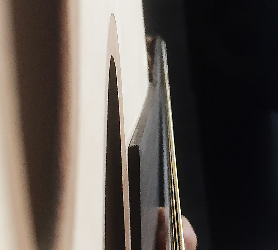

I got this one: AAOK-310G
The neck itself seems reasonably straight, and the action at the joint is 3+ mm. Just a bit more than I'd like. But the fretboard angles down with the top of the body so the action is 8 mm towards the end of the fretboard.
AAOK-301G_1.jpg - 111kB

What I think I am seeing in the photo seems impossibly bizarre. Can you post another photo that shows the entire top of the oud? I can't quite work out what I am actually seeing.

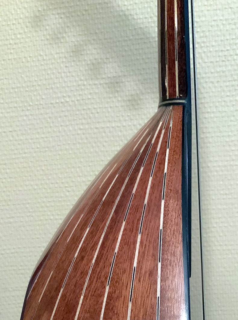

[*] posted on 8-18-2021 at 06:27 AM
Quote: Originally posted by coolsciguy
Other folks can correct me, but not the whole fret board is entirely "playable". The better sounding section of the oud is from the nut to the joint. from the joint onwards sound loses clarity; from joint halfway to the sound hole is still playable. All ouds have high action (7-8 mm) at the bridge, whith action gradually getting shorter moving closer to the nut.
The strings of a typical plucked string instrument, including a typical oud, produce a thick muted sound as the vibrating length shortens (as the player fingers higher up the fingerboard). As you say, a typical oud sounds clear up until the neck/body joint. I have an excellent oud from the shop of Faruk Turunz which sounds clear on each string right to the high end of the fingerboard. It was designed to do that. But that is an exceptional situation. But there seems to be a bizarre construction problem in this Sala oud. The photo suggests that the fingerboard makes a left turn!! I'm probably misinterpreting the photo. I hope so!
Ah, no it's not making a left turn :D It just sinks with the top.
Action at the bridge is 12 mm, which becomes 8 mm when reaching the fretboard. But the action is almost tripling from the neck joint to the end of the fretboard.
If this is acceptable on an oud, I'll also accept that :-)
How is the top of an oud supposed to be? Straight, slightly upward, sinking? On a healthy guitar, slightly upwards bow is normal. On this oud the top sinks quite a bit. That's ok? I just want to make sure that this oud will survive in the future, since as a guitarist I'm a bit scared by the sinking top and fretboard change :shrug:
oud.jpg - 182kB

I think what you are saying is that your soundboard sinks around the sound hole/end of fret board which is giving you high action in that area. Can't say if this is by design or a flaw. I owned one beginner Turkish spruce top oud which was like that. My Arabic cedar top oud isn't. There is a lot of variation in bracing the sound board which causes such behavior. Also, depending on your tuning and strings, you may be putting too much pressure on the soundboard.

It's common to see sunken tops on ouds over time but it isn't desirable and shouldn't be expected on a new instrument. It looks like the neck angle is steeper than would be expected on an oud and the bridge is probably higher than usual to compensate.

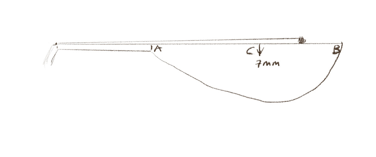

I'm measuring a bit...
Are ouds, or some ouds, designed with a curved top frame? Meaning that if one laid the oud face down before the top is mounted, it would not be flush with the floor?
Seems like that is the case here. I measured with a string from beside the neck joint (A) and down the length of the top to the bottom (B)(not quite to the bottom obviously, since I have to string beside the bridge).
In the middle (C), the top was about 7 mm down. See attached pic.
When measuring with a string across the top from side to side, the top is 3-4 mm down. So not quite the same....
oud-top.jpg - 26kB

No, oud tops are planed flat before pairing with the bowl. It is common for the top to sink over time but that typically takes several years if it happens and ouds are never built that way from the beginning.
