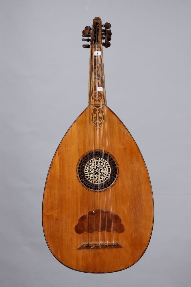

Hello

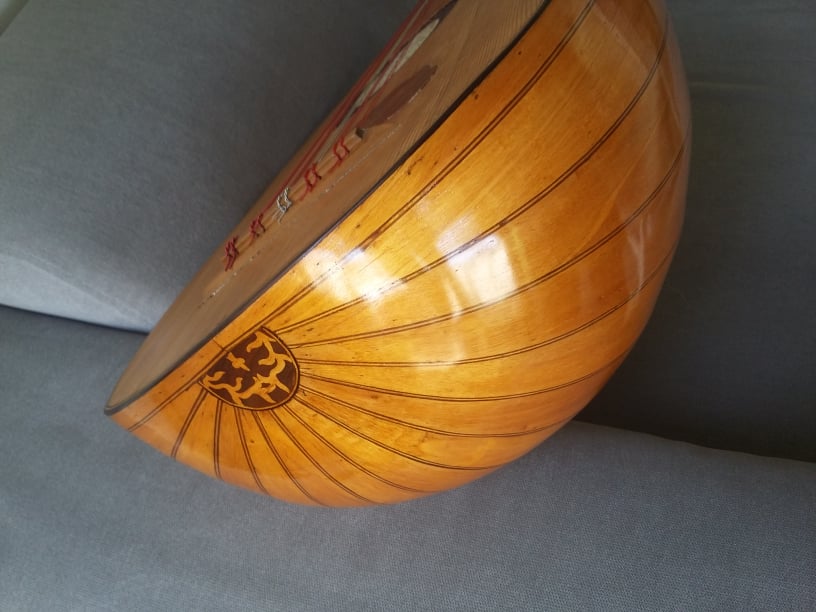

i would like to share this lovely finding i made.

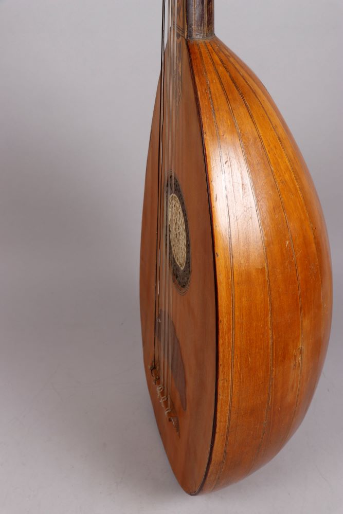

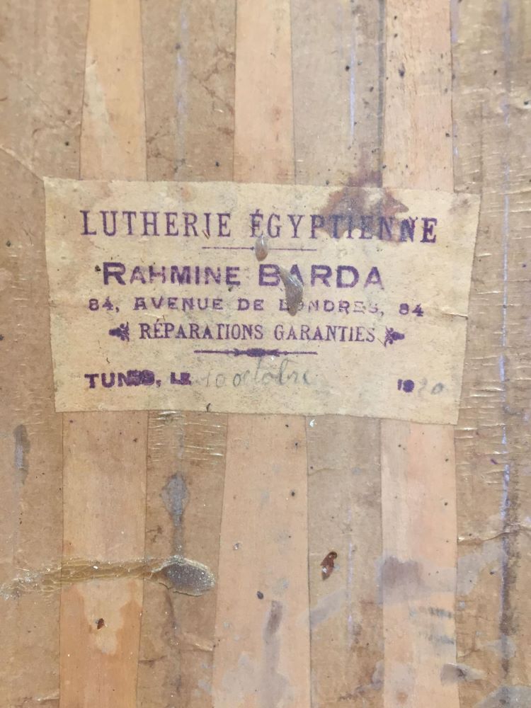

I cross this oud at the sale of a french private collector, and among oldies there was this oud, in a rough state of conservation.
Named from Rahmine Barda , labelled as egyptian lutherie in Tunis , 1920

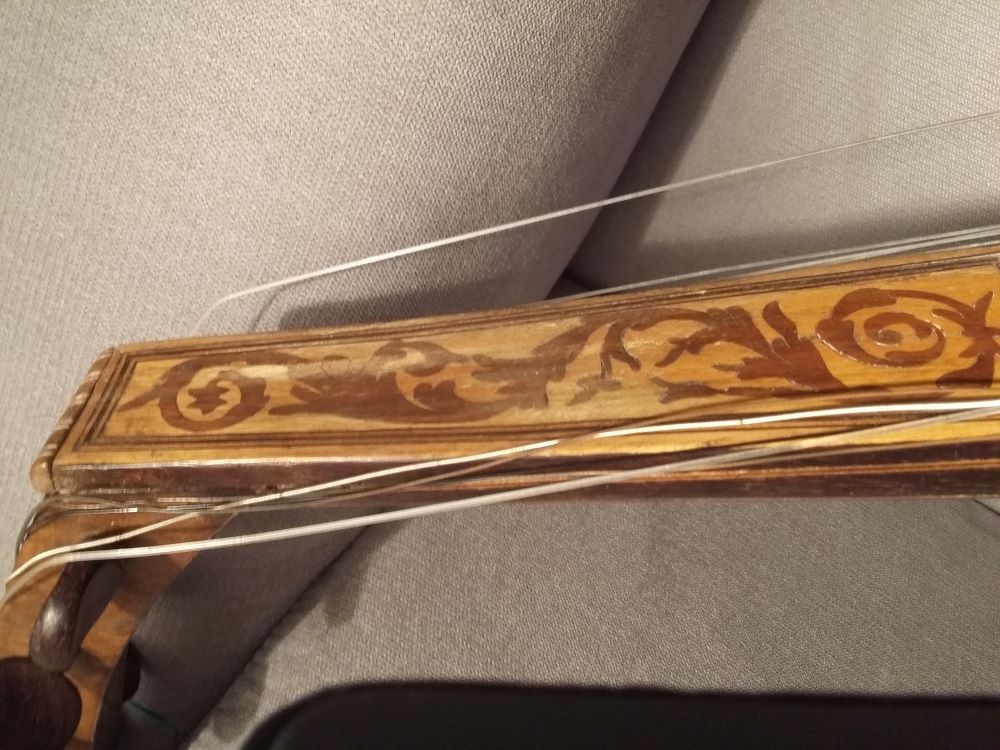

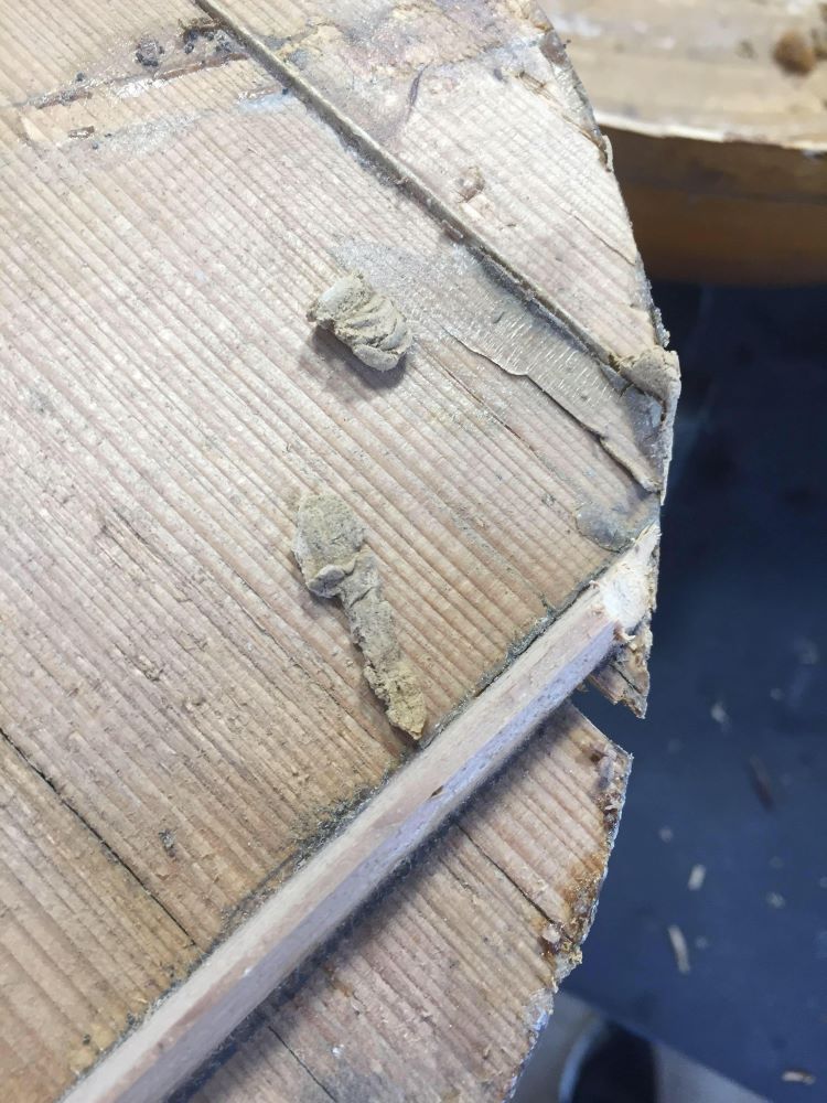

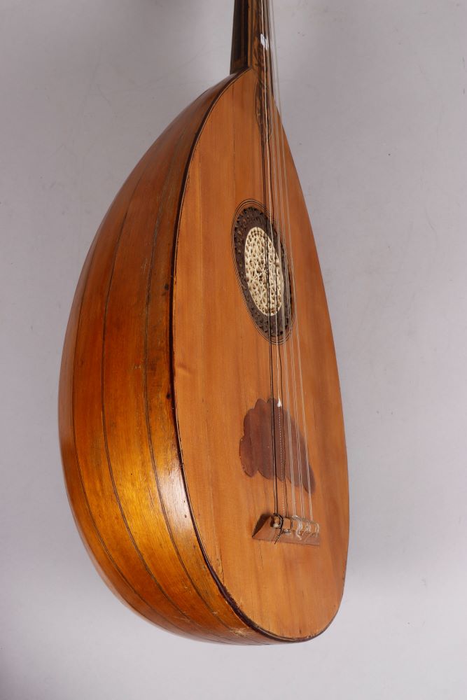

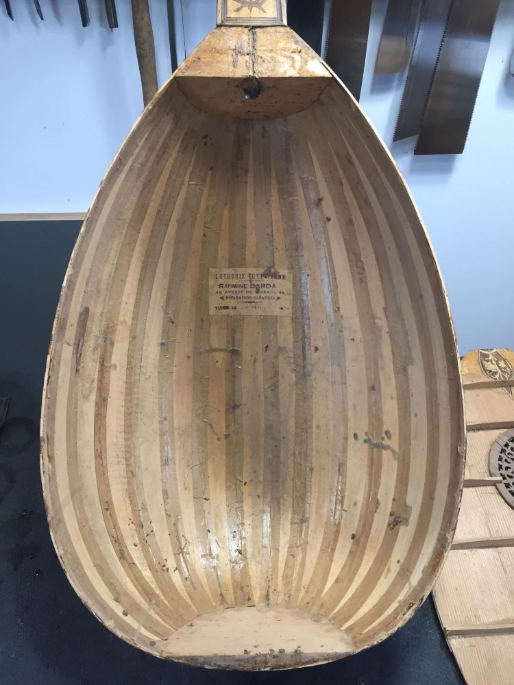

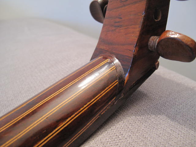

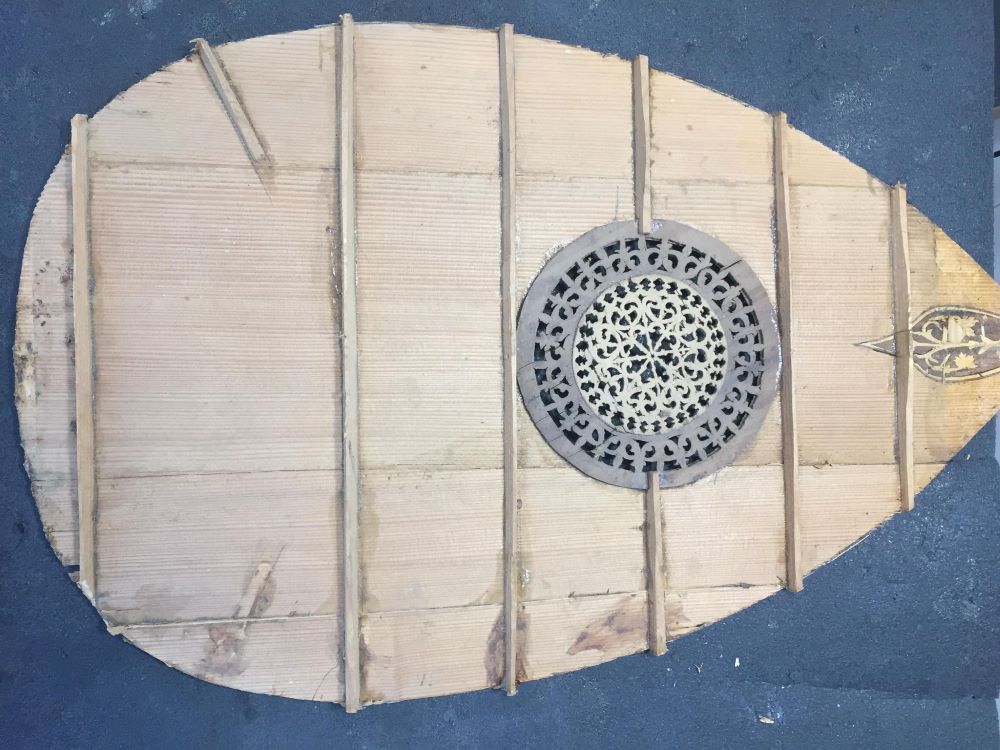

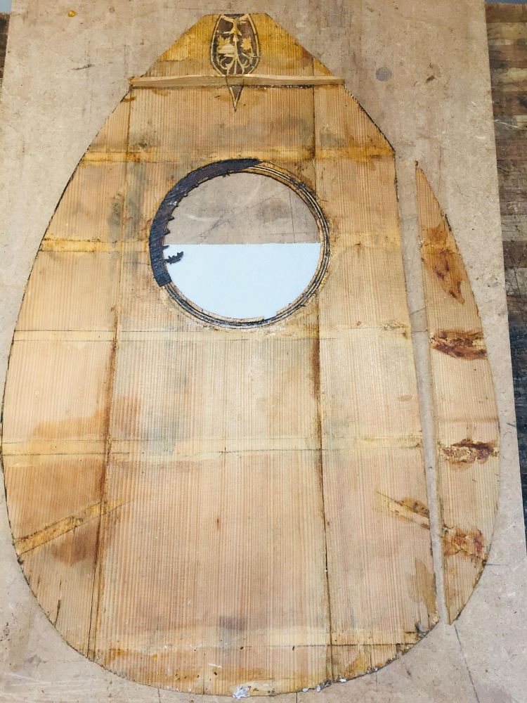

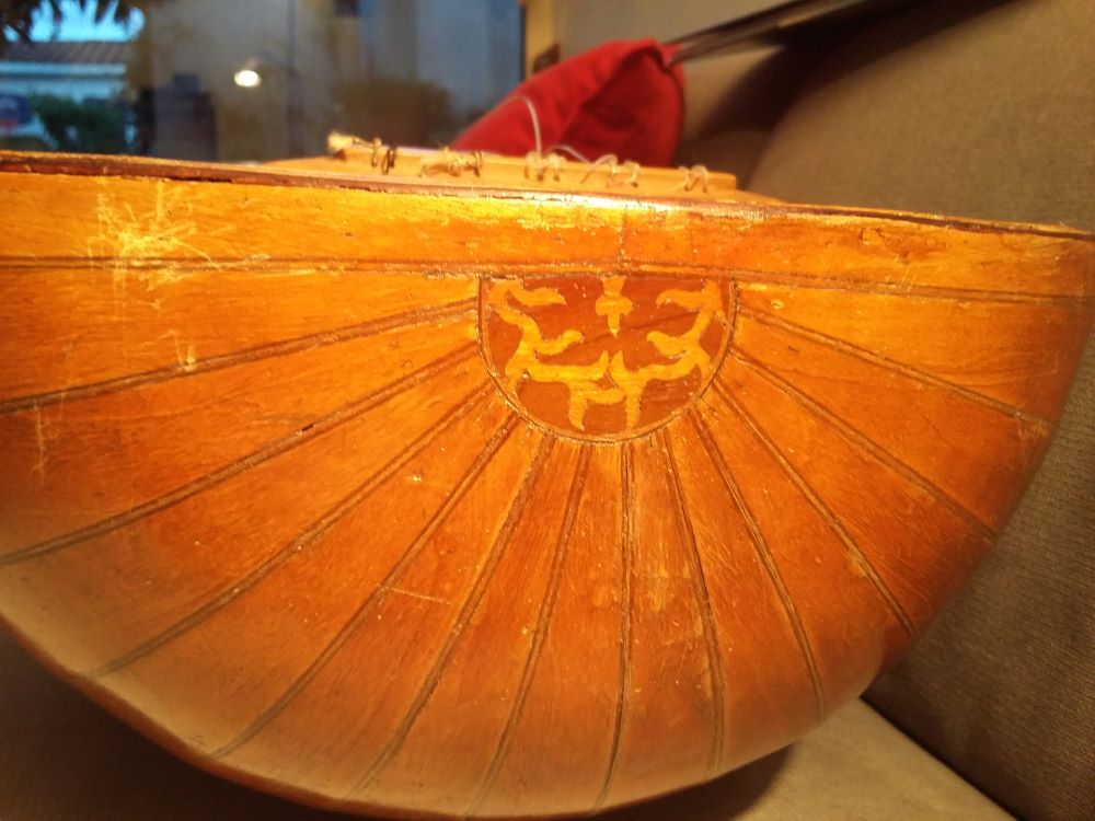

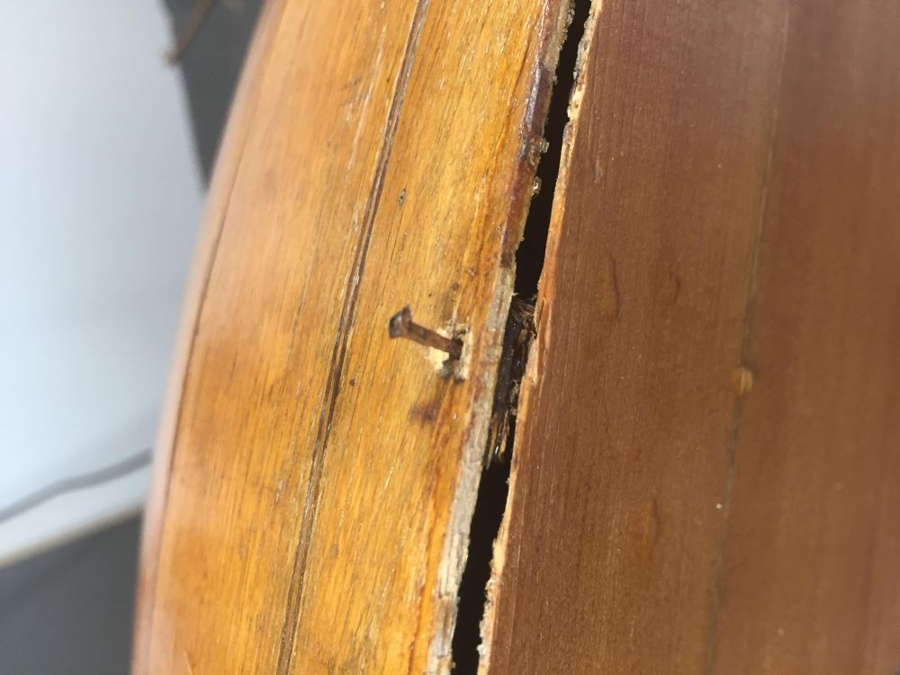

here is some pics of its original state. There was deformation of the soundboard, unglued braces. A varnished had been out on the soundboard after
some rough repairs of soundboard cracks. The neck, of a tender wood, has been dig by having been played. The soundboard filetery showed it has been
opened from bottom to be repair, bot not the whole soundboard had been take out for this process
here is a few pics of its original state as i got it. Not playable in this state

I entrusted the oud for full restoration to Thomas Dauge, a talented luthier of the area of Bordeaux, France.
And asked around for information about.
This way I heard about another one in a private collection (another one than this one). And also about an oud repaired by Rahmine Barda.
No pics for those
Then i had the luck, with the help of social medias, to find his family and had a few elements about.
Rahmine was a talented virtuoso of his era, violin player mainly. The family was from Alexandria before setteling in Tunis. They had an orchestra ,
making a living from music.
Rahmine Barda was very young when he made this oud in 1920, 19 years old , and unfortunately passed away early, 15 years later. He left a strong
memory as being have a great artist inside his family.
Stories has remained, and also a few pictures of him. But unfortunately not a single record has been kept within the family. I know he had represent
Tunis during a travel to USA, Chicago.

Regarding the specifications, the bowl is 52.2 length, 35 width, 18.5 depth. We couldn't identify the wood of the bowl. ( update: wondering if it is
yew wood )
the stringlength is 61.5 but the neck only 19 cm
The oud is extremely light, 840 gr including the strings
5 courses instrument, string spacement at bridge 82 mm. Neck 37 mm at nut, 60 at neck body joint

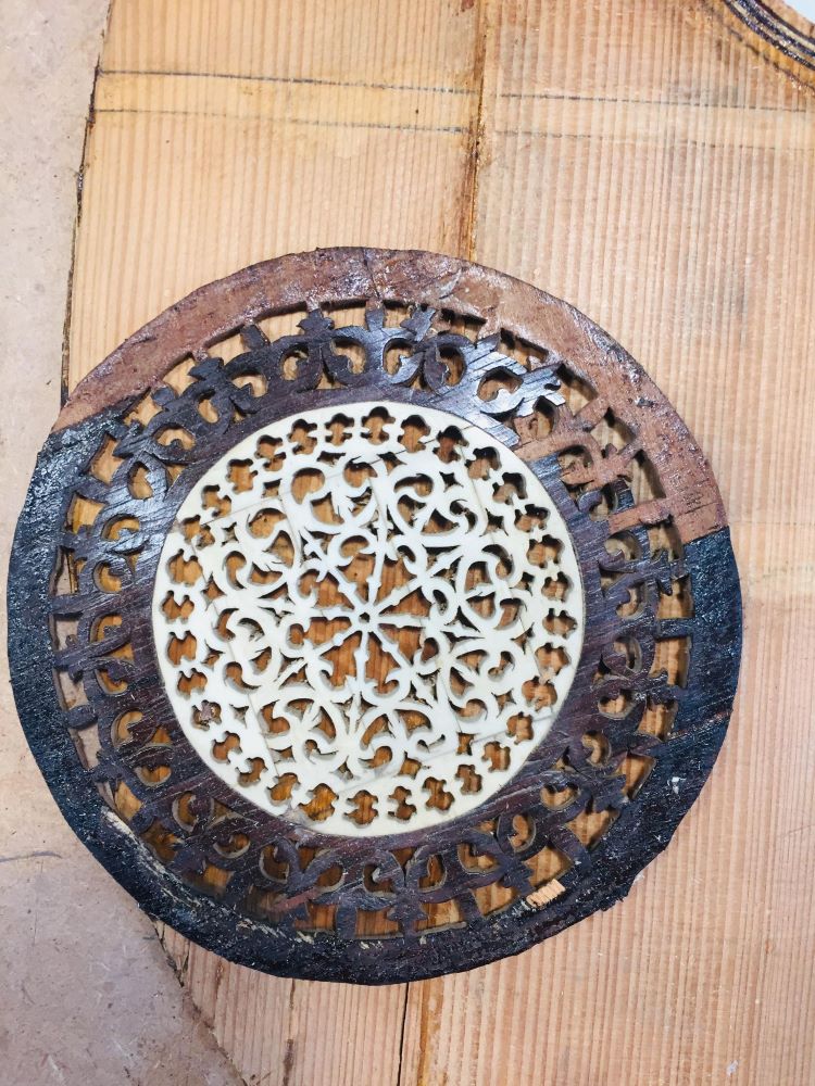

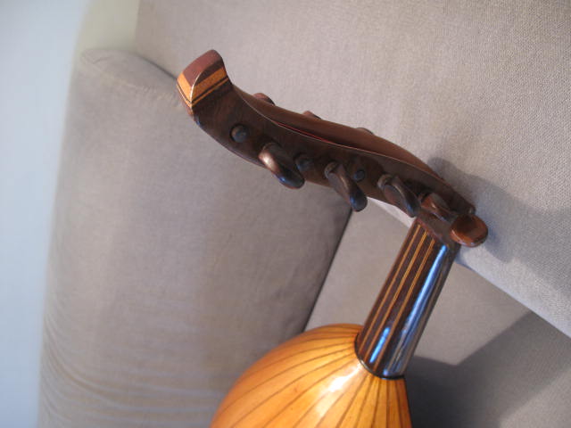

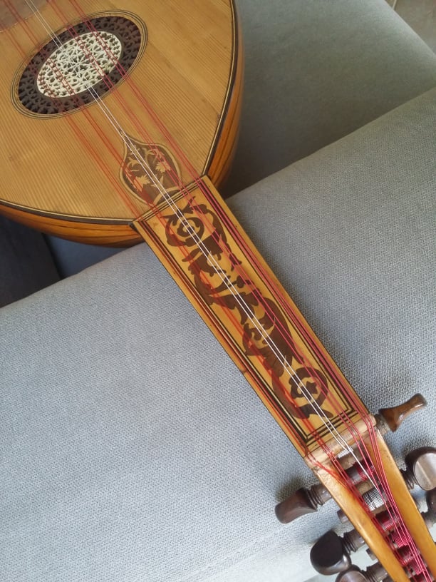

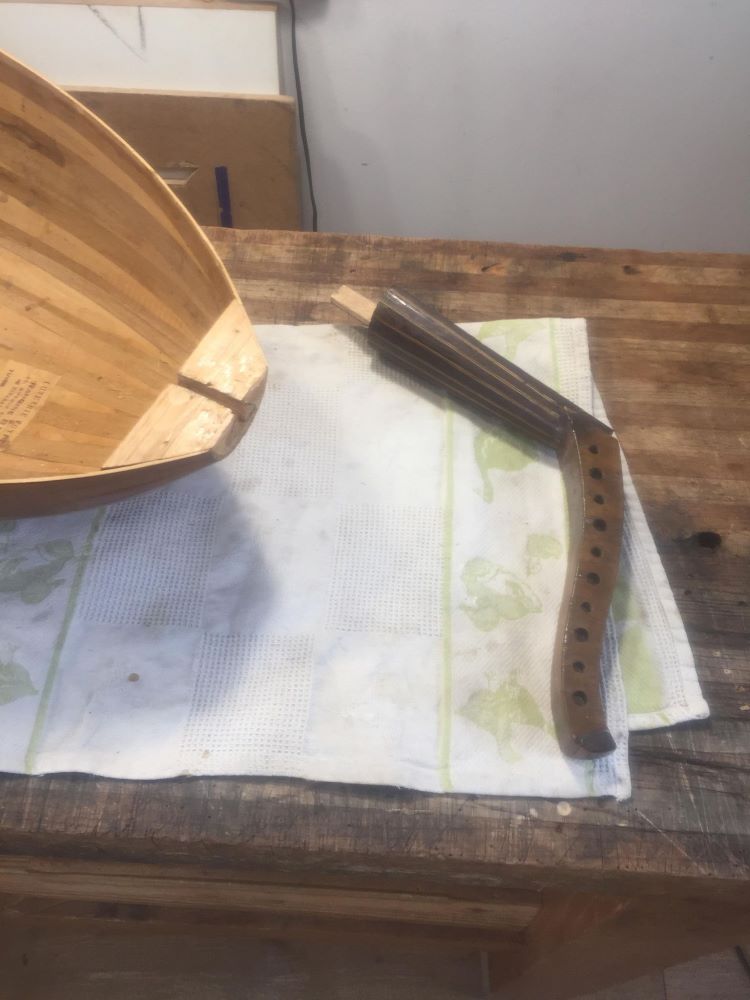

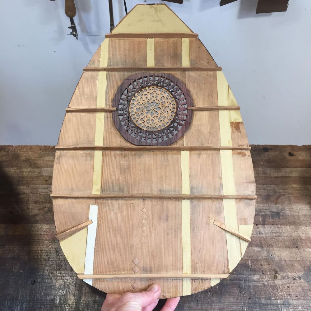

it deserved a lot of work, so Thomas went for dissamebled everything to work it

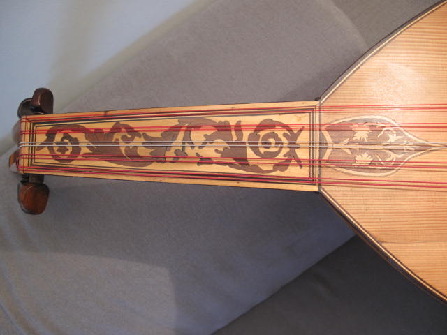

here is a few pics upon restoration. Patches were necessary for area of fragility because of previous repair or from how the wood worked. Cracked with
poor repair has been solved by spruce patche (flipot in french) .

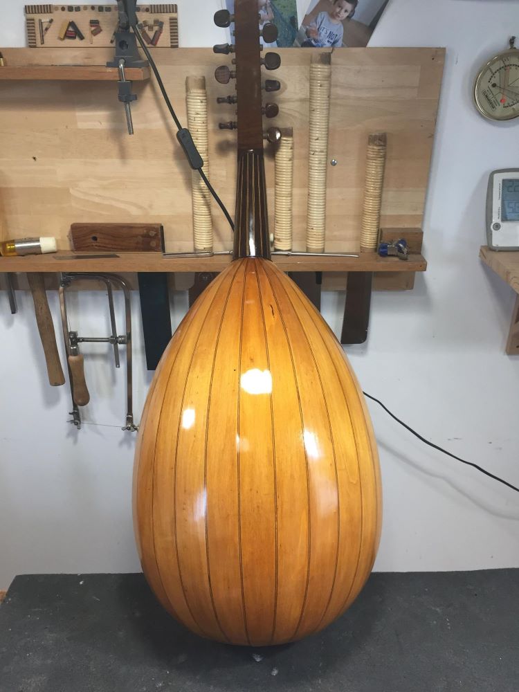

All in all the restoration process has been conservative of its original features.
A patch has been necessary at the peghead / neck joint to joint it finely.
The inlays of the fingerboard could have been kept while the fingerbaord has been leveled.
finishing is shellac on bowl and some layers of shellac on the fingerboard to protect it. With a simple process to maintain it at each change of
strings on the fingerboard.
The soundboard has been protected with specific wax, a finishing being used on lutes

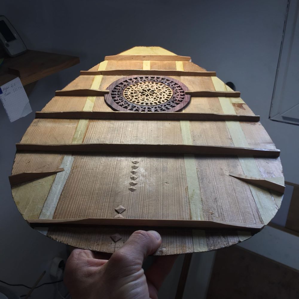

suz_i_dil
Posts: 1064
Registered: 1-10-2008
suz_i_dil
Posts: 1064

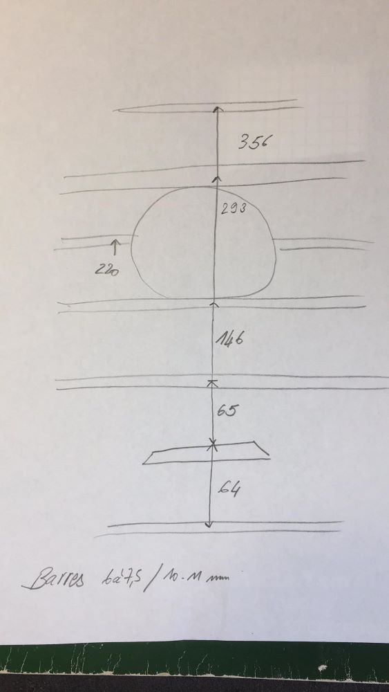

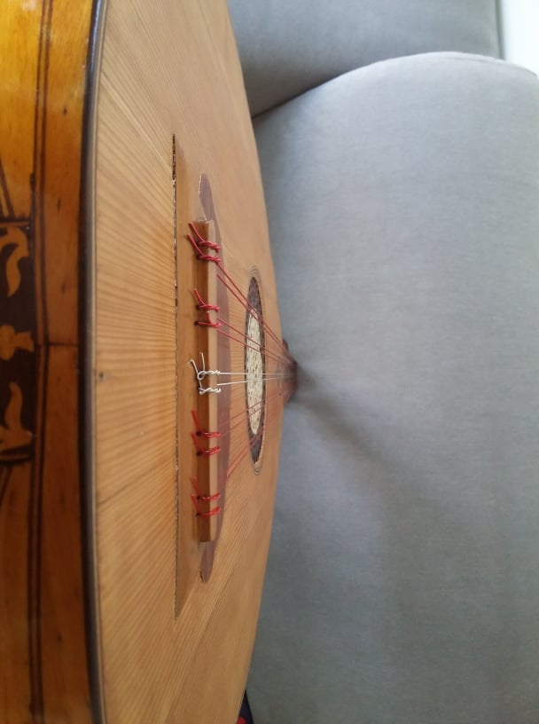

rough mapping of the bracing andf final state of the soundboard after restoration.
it is not braced on overtones, after an hypothesis i had made there.

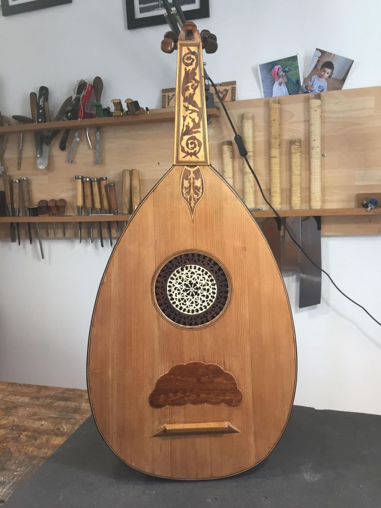

suz_i_dil
Posts: 1064

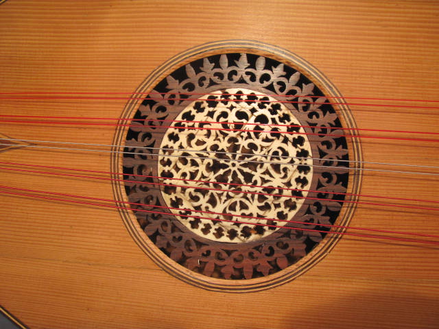

now it is ready.
I let it settle and time for me to familiarize with it before sharing a record with you about
