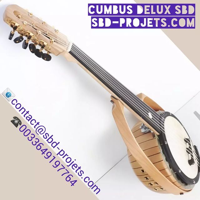

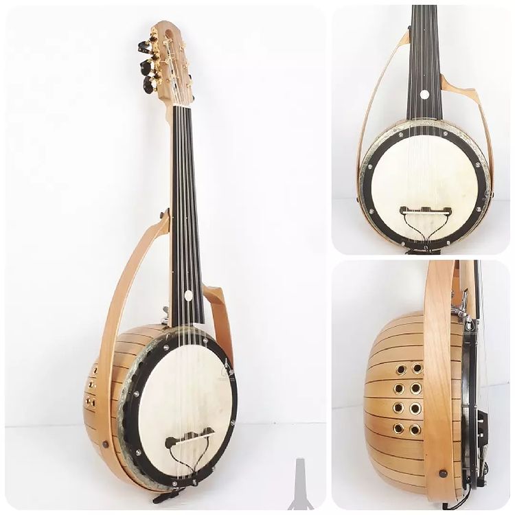

"many things ! the strings are nylon, the bridge is wider, the tailpiece to accommodate nylon strings, the fingerboard and therefore the neck are more conical (the cumbus has a neck with almost parallel edges), the saddles are made of bone, the hoops are made of wood to balance the instrument (the cumbus leans on the body so the musician wears the entire neck while playing), the soundholes to better hear the sound, bumps on the back of the neck to imitate the base of the peg box ...."
Sometimes pics and video speak better so ...
Cumbus delux sbd
https://www.youtube.com/watch?v=a6KMEYVONVw
cumbus delux sbd oud arabic acoustic luthiery france - insta.jpg - 56kB cumbus delux sbd oud arabic acoustic luthiery france - face profil back.jpg - 57kB

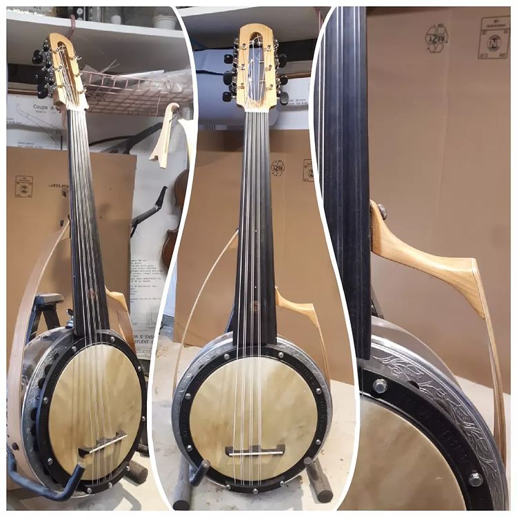

Cumbus sbd (steel body)
https://www.youtube.com/watch?v=h283NDT9d6M
cumbus steel sbd oud arabic acoustic luthiery france - face profil back.jpg - 91kB
