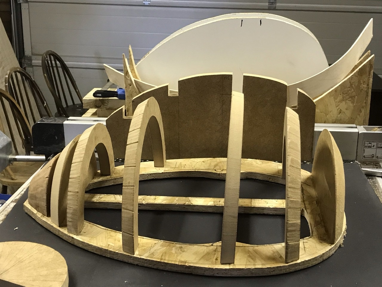

I've watched some videos of oud makers. They use a special lay-up form/mold to make the bowl.
What are these made of and how?
Kelly
Registered: 1-30-2007
Location: Manchester, UK
[*] posted on 12-20-2021 at 11:48 PM
Hi Chaz
You can use mdf or ply whatever you have lying about. Just check that all your ‘hoops’ line up with the curvature of your central spine/ template.
A50AC580-C3BA-4559-8D76-457B93561395.jpeg - 338kB
