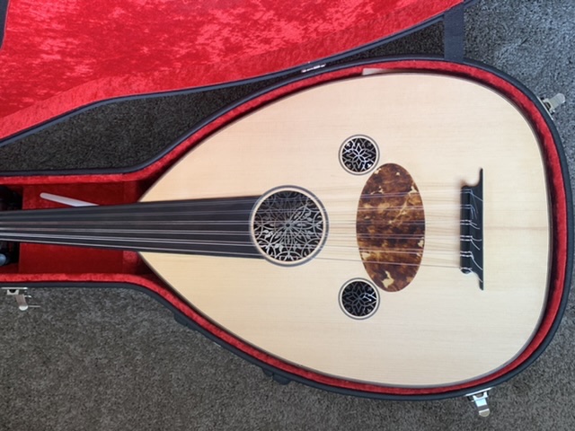

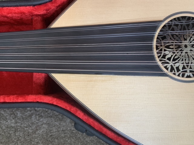

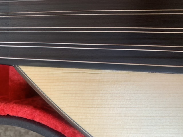

[*] posted on 3-6-2022 at 09:19 AM
Hello
I used hide glue to seal the crack, dampened the area first and used very little which i rubbed in. Before doing this i removed the strings and bought a humidifier to bring humidity to around 45%. I was hoping that crack would seal itself once humidity was at ~ 45, which is when i started the glueing. It doesn’t look great but the crack is sealed and hasn’t gotten any larger.
Here are some photos -
B6C9C7F5-8E30-44ED-9C4D-B814A3174249.jpeg - 73kB 8BD08F23-8852-4080-AEA1-7D653F0E95EA.jpeg - 110kB 5889F540-3D94-4FD9-8D81-6837A7BF385C.jpeg - 93kB
