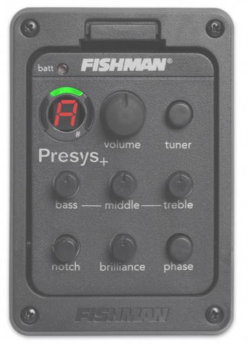

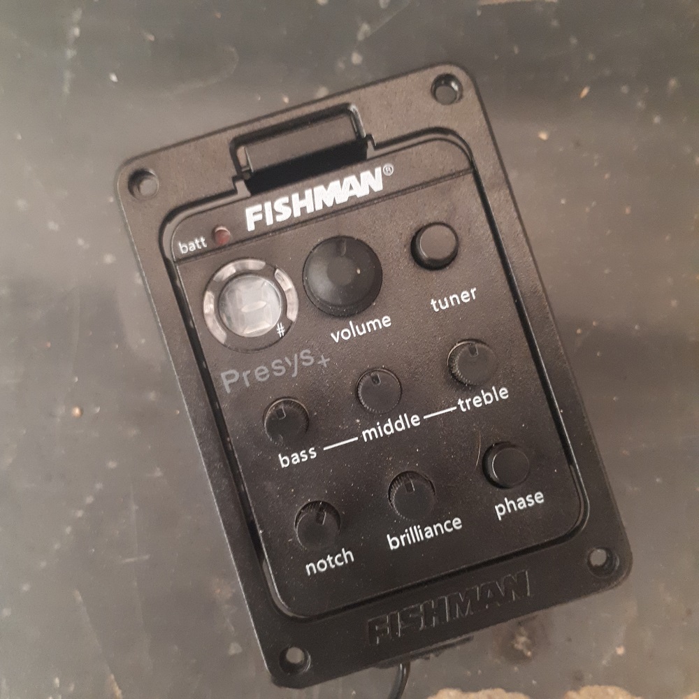

- Preamp : Be carrefull ! Sometimes you can buy instrument with counterfeit preamp. See details in right attached a Fishman example particulary
looking name model here "Presys +" often installed on electric ouds. This added name on preamp body is here baddly written so you can check it
yourself before buying . In fact this counterfeit costs around 25-30$ on web instead of more than 200$ for truely Fisham preamp ! It could change a
lot final price of instrument ...
Furthermore this bad preamp given a bad sound with a lot of parasite.
