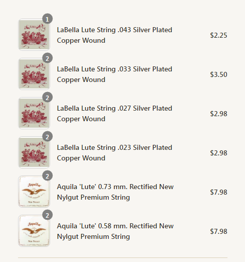

[*] posted on 11-2-2022 at 06:16 AM
Thank you very much for your information.
Your first recommendation is these in attached photo? That's right?
2022-11-02_16-10-47.png - 72kB
Posts: 2939
[*] posted on 11-3-2022 at 07:13 AM
yes, exactly
