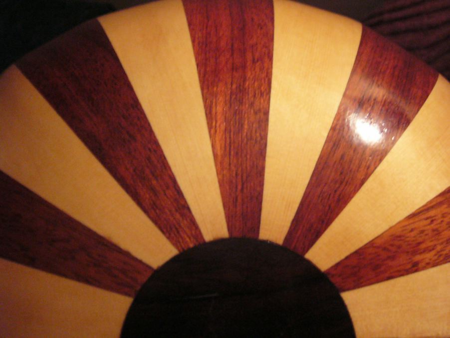

in this post I will talk a little about the changes I made in my first oud, and needless to say that every thing i write here is only my own opinion and I'm not suggesting for any one to adopt my methods ,all I'm trying to do is finding new ways to approach oud building based on my experience and imagination, so I can learn from it and share my findings (right or wrong ) with the people in this forum.
The wood I choose for the back is Canadian cypress and mahogany ,I like working with cypress because it's
* easy to bend
*easy to sand
* it polishes really will, and it has a bright and clear tone that i like.
I used 24 hours two parts epoxy for gluing the ribs.I used it because
* it has a long open time
* for it's incredible strength.
I also tried using something called (gorilla glue) for it's promised strength , but the next day when i started scraping the excess glue it raised the temperature of the wood surface and that led to the joint to fail immediately, so i didn't use it for anything else.
I didn't have a lot of problems in that stage although it took a long time to finish.
I used the two block technique with bending the ribs by hand with a bending iron.

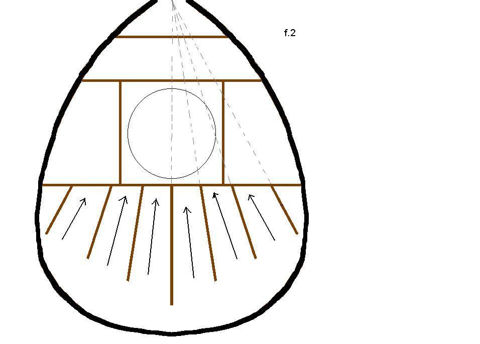

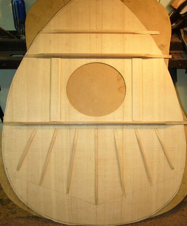

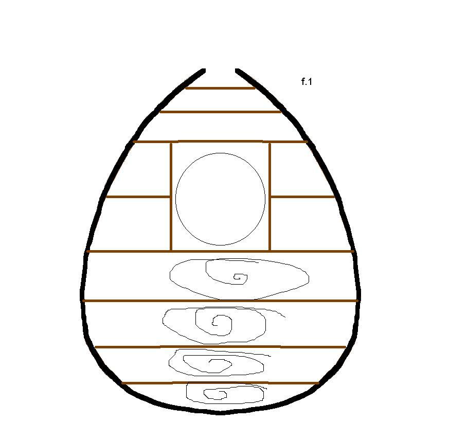

I will continue today with talking a little bit about the project, and the most important part of it which is bracing the top.
with what i saw from the old oud that i got and pictures from the internet of top bracing patterns that made me stop the building procedure completely until i solve the problem i was facing , to me the choices where clear :do the bracing system as it is traditionally made . see figure (1) .or I can open up the braces underneath the bridge and align them in a fan bracing pattern (classical style) to direct the acoustic waves away from the deep end of the body and into the sound hole and then out of it. see figure (2).
after bracing the top. See figure (3).i tapped tuned the whole soundboard by shaving tiny pieces here and there until the sound produced by tapping was muffled with no high or low harmonics, and that was it for the top .i can explain more if needed.

It would seem that you have the ends of the ribs so thin that there would be no way to effectively attach the top to the rest of the instrument.
Also, the bottom of the face would not be attached to the bowl (only by the very edge of the top itself).
I think that pattern would work better on an instrument like the guitar, which relies on kerfing strips to hold the top in place. Looking at the photograph on top, it looks like you have placed kerfing, or that it was there already. Are you planning on using this?
An oud relies on the braces to stabilize the face, and help attach it to the bowl. In the picture of your braces, there is nothing holding the bottom half of the face to the rest of the oud. I think that with that pattern when you string it up, it would come loose from the bowl.
Just a couple of thoughts. I await input from people more knowledgable than myself.

You mentioned that the traditional ladder bracing makes no sense. I don't know enough about bracing physics to comment, but the western lute, which sprung directly from the oud, uses nearly identical bracing.

I gather that you are not done yet with your bracing. Are you planning on adding the bottom V-struts or you are going to depart from Torres's bracing pattern? What is the thickness of your soundboard? Can you please share with us the dimensions of your oud? I have also noticed that the soundhole area will be weak if you are not going to use additional finger bracing next to the soundhole graft, how are you going to compensate for this?

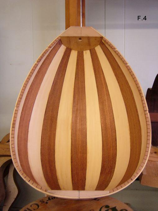

Jonathan asked about the braces ends . i used Spanish cedar lining on the edges of the bowl to increase the gluing surface, so there was no need to keep the end of the braces tall, and didn't have to cut them exactly the size of the inside of the bowl , so i just cut notches two to three mm deep in the lining and the ribs edges to seat the braces in. See figure (4) .
I would like to thank jameel for his comments .i really admire his work.
The answer to hosam first question: the oud was finished a week a ago,but I'm waiting for a second opinion on the results (to me it sounds loud and immediate , but I'm not a very good oud player) ,so if any oud players are passing through Edmonton, please stop by the shop and play it, i would love to get some feed back.
I didn't install V struts because i kept the top (2 -2.5)mm thick so there was no need for it .and that also answers the sound hole question.

Hello Zeryab, It looks great. I use fan bracing too, a slightly different pattern, on my ouds and make my own kerfed linings, which is the system I use to glue on the soundboard. It works for me and have not had any of my soundboards fail under stress yet in 8 years. My bracing is also narrow and low profile.
