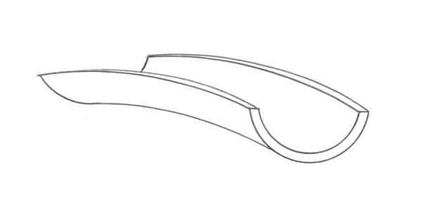

Thin and flat, (under 1.5 mm thickness) lute ribs, when bent to shape on a lute bowl mold, will take up a natural, shallow curve, or 'fluting' in cross section. This is due to the transverse and longitudinal stresses in the bent rib coming into an equilibrium, or balance, state. This feature may be less pronounced in ribs made from thicker material - as might be found in modern oud construction.

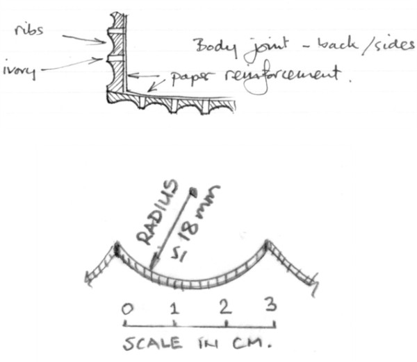

Fluted ribs, formed by bending, may be found on two, well known, surviving instruments - a guitar by Belchior Dias, dated 1581, in the Royal College of Music, London and a vihuela cat. E7048 in the Cite de la Musique museum in Paris. (There is some dispute about the designation of these instruments as guitars or vihuelas but these arguments are irrelevant to this investigation). The attached image shows a section through the central rib of the Dias guitar drawn to scale having a radius of the fluting about 18 mm and a reverse curve longitudinally having a radius of about 33 inches (838 mm).
This is a shallow longitudinal curve compared to an oud or lute rib, however, the guitar/vihuela ribs have sides that are relatively parallel whereas lute and oud ribs taper sharply longitudinally. This sharp taper might make it possible to form fluted oud and lute ribs by bending alone although I am not aware of any surviving early lutes or ouds that have this feature
The current wisdom, however, is that deeply fluted oud or lute ribs can only be made by carving and there are examples of modern luthiers making instruments in this manner.
Fluted Rib comp 2 (600 x 522).jpg - 29kB

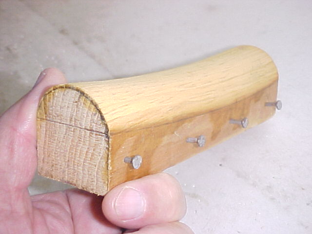

The objective of this first part of the experimental process is to try to get a general feel, quickly, for what bending procedures may or may not work in practice. Samples of seasoned American walnut and Maple - quarter sawn - measuring about 35 mm wide by 135 mm long by 1.2 mm thick (1.375 X 5.30 X 1/16 inches) were prepared, planed smooth both sides.
A 'male' mold, (the type used by luthier Dan Larson), on which the test pieces will be formed - representing the geometry of the central rib of the 16th C Dias guitar - was cut from a piece of pine. The mold is about half the length of the Dias rib for preliminary test purposes - to save time and material. This mold configuration is the easiest to manufacture - quickly made by cutting the longitudinal curve on a bandsaw and then shaping the cross section with a rasp. The longitudinal curvature of the mold was made with a radius of 27 inches (656 mm) - tighter than that of the original Dias rib (33 inches/ 838 mm), to allow for some anticipated 'spring back' of a bent rib after release from the mold. The longitudinal curvature was accurately measured using a set of standard draughting curves.
The attached image shows the completed test mold. The nails in the side are convenient anchor points for the string that will be used to tie down the sample to the mold
So - ready to go for the first test.
Fluted Rib Test Mold.JPG - 37kB

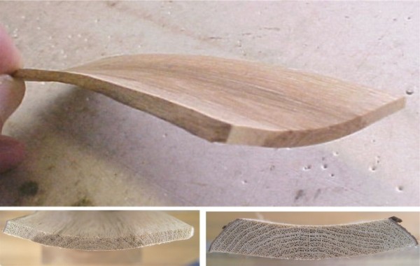

Wood, when freshly cut and full of sap ('green' wood) - dependant upon the species, - may be soft and flexible enough to be formed to shape on a mold where it will permanently attain (within limits) the shape of the mold on drying and seasoning. The disadvantage of this method is that it is slow and the wood may be subject to cracks and splits during the drying process unless carefully controlled. Also, slab cut wood is less stable than quarter sawn under variable humidity conditions.
For information and interest, here is an image of a sample of wood (vinewood) that was slab cut from a 2 inch (50 mm) stem earlier this year and allowed to air dry. Note that the sample, on drying, has naturally attained (almost!) the ' inverted saddle shaped' geometric profile that is the objective of these test - without using a mold!!
Also, this vinewood has no visible seasoning splits or cracks.
The reason that this sample has taken a fluted profile is because of the differential grain length across the slab cut section - shorter at the bottom of the sample than at the top so that the shrinkage on drying is less at the bottom than on the top of the section (see the bottom two images of end grain). The longer the grain length the greater the amount of shrinkage. Also, as the transverse stresses induced by this natural curvature must be balanced by an equal and opposite stress, an opposing longitudinal curve can be seen in the sample.
This is test #2 which may have some useful future application.
Fluted Vine comp (786 x 498) (600 x 380).jpg - 45kB
