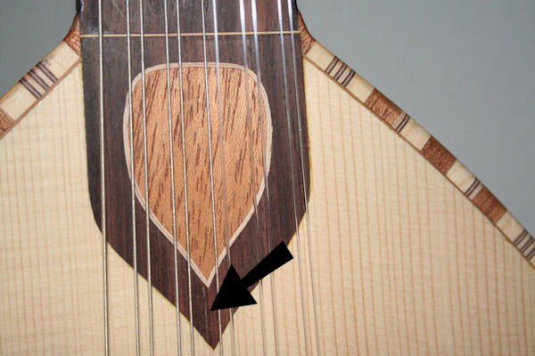

Hello everybody.
After 10 months silent I come back to give some informations about the maturing of my oud and about the major faults or defects after practicing .
No problem with the wood behaviour of the back , fingerboard or the top ,excepted a small crack in the beard which appears after 3 months .Strange....I did not expected a crack in this area.
By playing there is an echo of the others strings which are not played in particular the bass strings .I don't know whether there is something the correct or whether I have to live with it .
Do anybody have any idea ?
The strings are a little to high making playing not so "confortable". So I decided to correct this defect on the way I will describe in my next step
IMG_2475.JPG - 56kB

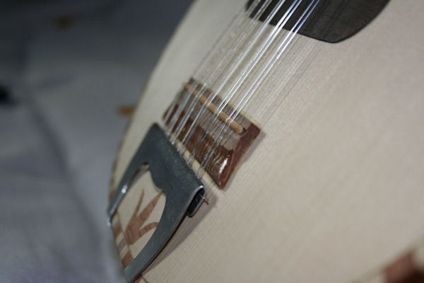

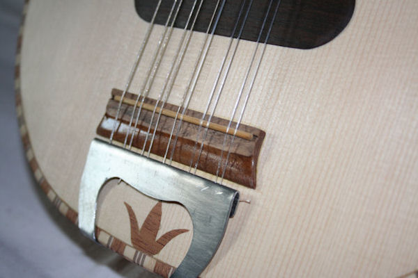

Drilling all the string holes at the same height in the bridge is not easy as the drilling device , due to the small diameter ,deviates with the vain .Consequently some strings were higher than the others.
removing the bridge without damaging the sound board was for me an issue and I did not dare to do it.I prefered to rework the top of the bridge with the Dremel tool,down to 4mm high ,adding a groove for a round profile .I had to make a metal piece (stainless steel) to attach the strings .
The configuration is now a glued "floating" bridge .It is not so traditional ,but I am happy of the result .Playing is much more pleasant and there is an improvement of the sound.
For the round profile I tried a brass stick. =>not satisfying.
I got the best result with a piece of bamboo (skewer for kebabs).
I red on this forum that the braces do not work on the same way with a flotting bridge .I will see with the time and take it into account if I make a second oud.
IMG_2473.JPG - 45kB IMG_2474.JPG - 31kB
